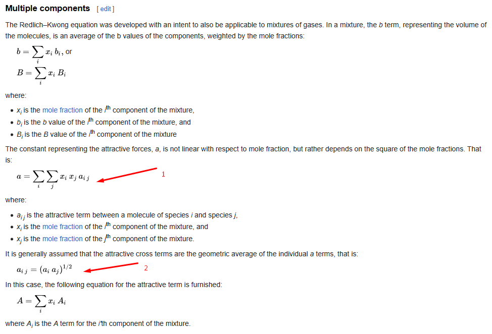

I have a question regarding mixture rules of mentioned EOS & particularly the math notation that I could not comprehend
In the attached image what does this Math notation means -- annotated as 1?
e.g if I have x2 species
x1= 0.6 x2=0.4 (mol frac)
a1= 0.16 a2=0.4 (constants)
what does this notation with double summation will do with these values?
Second alternative -- annotated as 2, does it imply following construct?
1] GeomatricAVG = (0.16 * 0.14) ^ 1/2 -- 1/n where n is 2 bcz its a binary mixture
2] A = 0.6 * GeomatricAVG + 0.4 * GeomatricAVG

WroteIn the attached image what does this Math notation means -- annotated as 1?
Hi. It means that, given the relationship between the "a's" of each component and the "a" of the mixture, you need a matrix of interaction coefficients to determine the attractive potential of molecules coefficient for the mixture, which is usually found by assuming that each coefficient in the matrix is the geometric mean of the component coefficients.
A complete example of how the Redlich-Kwong model is used for a mixture in the attached.
