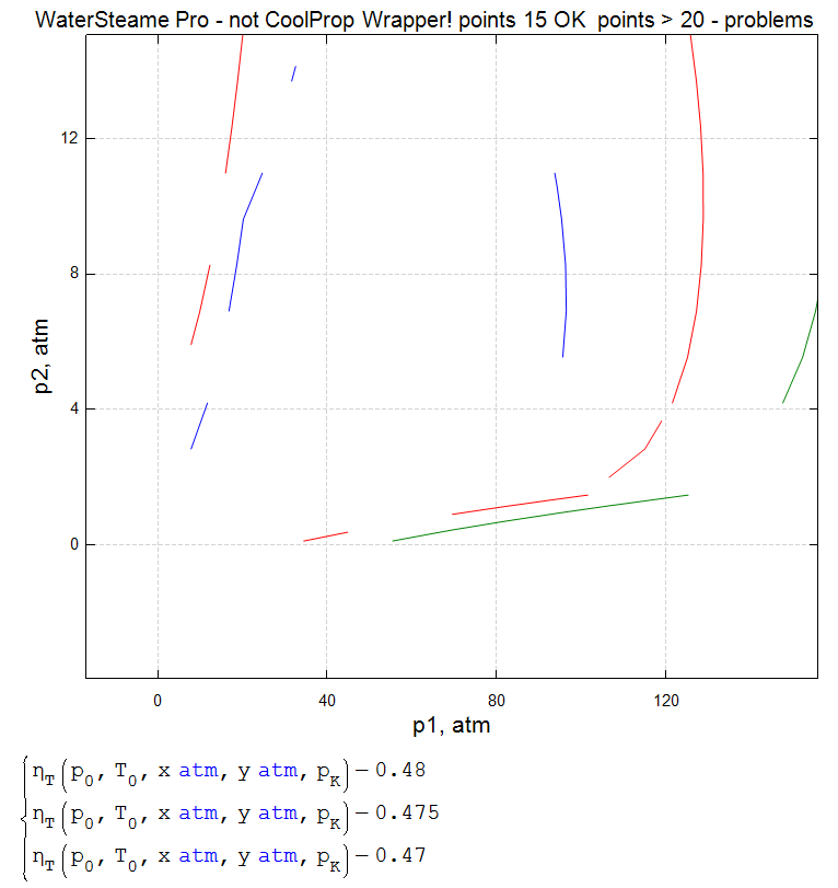

#1 Posted: 6/19/2024 6:34:29 PM
Valery Ochkov
Valery Ochkov
67 likes in 713 posts.
2RegP-Ideal-Cool_Prop.sm (82.18 KiB) downloaded 1624 time(s).

Valery Ochkov 7/22/2024 5:02:00 PM

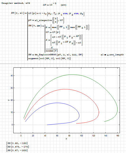

#3 Posted: 7/24/2024 1:29:16 PM
1,139 likes in 1,805 posts.
Hi. You can use the Draghilev's method for parametrize a curve.
2RegP-Ideal-Cool_Prop (1).sm (82.56 KiB) downloaded 1556 time(s).
2RegP-Ideal-Cool_Prop (1).pdf (317.07 KiB) downloaded 932 time(s).
Valery Ochkov 7/24/2024 2:02:00 PM, Вячеслав Мезенцев 7/24/2024 3:55:00 PM

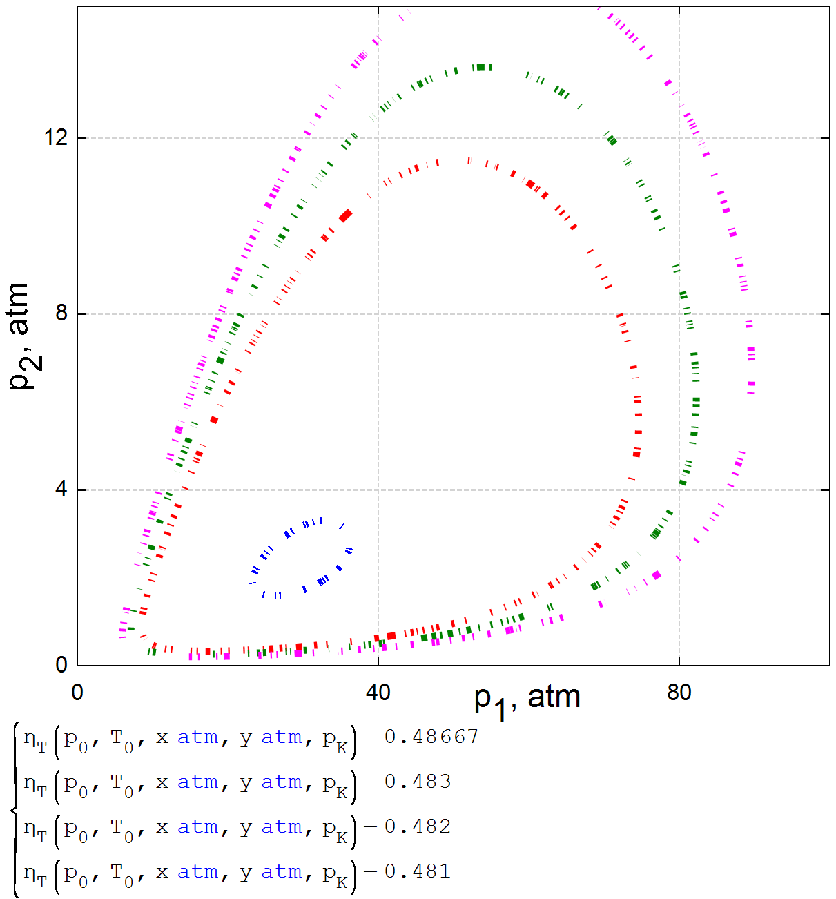

#4 Posted: 8/5/2024 1:51:05 PM
Valery Ochkov
Valery Ochkov
My solution
