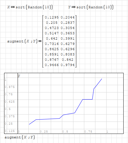

I'm sure that this must be easy, but I can't seem to do it.
I have a set of (x,y) data points (measurements, not generated by a function). How do I plot these as a line plot?
TIA
#2 Posted: 12/21/2023 2:59:28 AM
599 likes in 1,381 posts.
You can use augment() function.
#3 Posted: 12/21/2023 11:35:38 PM
I have a set of (x,y) data points (measurements, not generated by a function).How do I plot these as a line plot ?
Augment experimental data [X,Y], simply plot.
Next, you may want to fit a model function.
If not too long attach an image ... NOT more than 4 decimals.

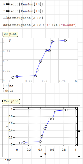

Next request: is there a way of showing the data points joined by lines on the plot?
Again, TIA
#6 Posted: 12/22/2023 6:08:56 AM
I've used MathCad for decades, and have that system in my head: finding my way around SMath is a bit different.
SMath is similar to Mathcad but not the same.
If you give SMath a try you will get used to it.
I find documentation is quite detailed actually.
Not a problem if you don't, feel free to ask anything.
This is a very friendly forum, you will get a working answer.
You can either use a new plot for dots or feature of X-Y plot plugin.
Double click to X-Y plot, there is option for dots under;
Traces > Appearance > SymbolStyle > Type.
I generally prefer using 2D plot for its simplicity whenever I can.
Sometimes X-Y plot plugin is required nonetheless, especially on x + y functions.
X-Y plot can do anything 2D plot does, except the animations.
And X-Y plot plugin has many detailed customizable options.
You have much control over Axis, Title, Labels, etc.
Here is a sample for your request.
dot_sample.sm (5.95 KiB) downloaded 1534 time(s).
