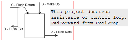

In my plant 20 pumps require flush water which is supplied by a close circuit water flow network. Flush rate & max temperature rise are per vendor specifications. Hot purge & simultaneous volume makeup by fresh water is what maintains the temperature.
I am attaching my solution to the problem. I further need to have multiple plots (on same graph) which corresponds to different temperature rises indicated by equation defining Tc. Please advice

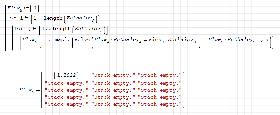

This should have worked ...the data dimensions are correct

I am waiting for a heat exchanger (with temperature loop) which will take x3 months. In the meantime I want to use make up water for temperature control by hot bleeding. Bleeded stream will not be wasted & goes to Cooling Tower makeup ...
Better wait the heat exchanger c/w control loop.
Detail: most likely the control algorithm will be Lead/Lag.
Your document is red. I will revisit.

Jean, can we use solve() command somehow?
No luck, your document is red with 1 page long error message.
You are trying to plot something, tabulate the data set.
From there, no problem to fit/solve.
Cheers ... Jean.

Now I have x2 matrices (ranges) changing TB (5 values) which plot a curve at changing TC (3 values) ...so we have x3 curves. Can you change attached file to my requirement
FlushWater_updatedCoolProp3.sm (89.35 KiB) downloaded 1286 time(s).

Jean, because CoolProp addin is not installed (I am also using secant() from nonlinear addin) thats why its throwing error. Check the pdf. Any recommendations from your side
Flush Water.pdf (359.31 KiB) downloaded 821 time(s).
