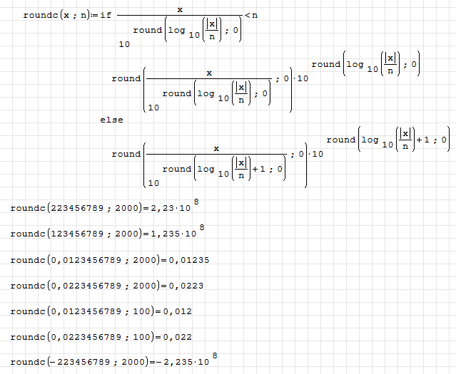

#6 Posted: 11/6/2014 4:35:07 PM
brotjob
brotjob
7 likes in 71 posts.
I created a demo file consisting of a function roundc() that does what I suggest.

#9 Posted: 12/10/2014 6:00:27 PM
brotjob
brotjob
I improved the function with exceptions handling. improved counts rounding
