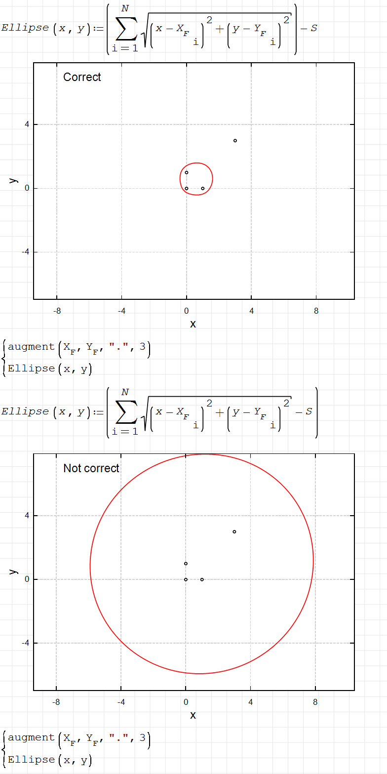

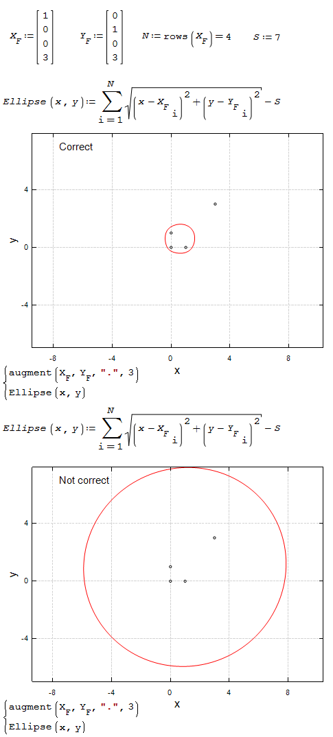

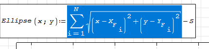

My students were building a multifocal ellipse and... almost went crazy. My ellipse is correct, but the student's is incorrect. Although the formulas are the same.
Can you guess where the error is and whether it is necessary to modify SMath so that such an error is visible?

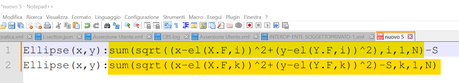

In fact only apparently the written formula is the same but in the first case "S" is outside the summation while in the second case it is inside the summation. You can verify this by copying and pasting the two formulas into a text editor.

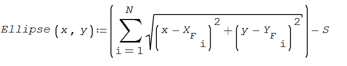

#3 Posted: 9/7/2023 11:58:54 AM
Arie
Arie
94 likes in 285 posts.
Further illustrated by adding parenthesis around the summation in each formula

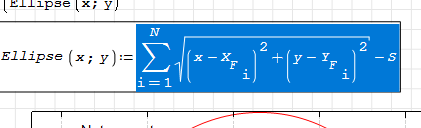

#4 Posted: 9/7/2023 12:00:34 PM
1,443 likes in 2,935 posts.
Show Spoiler
You can also select/double-click the sum symbol to check what belongs to it.

The problem is that in the first Ellipse(x,y) definition, variable S is outside Sum function, but in the definition of your students is inside:
Your definition:
Ellipse(x,y):sum(sqrt((x-el(X.F,i))^2+(y-el(Y.F,i))^2),i,1,N)-S
Student´s definition:
Ellipse(x,y):sum(sqrt((x-el(X.F,i))^2+(y-el(Y.F,i))^2)-S,i,1,N)
Maybe, this explicit form is most clear for students:

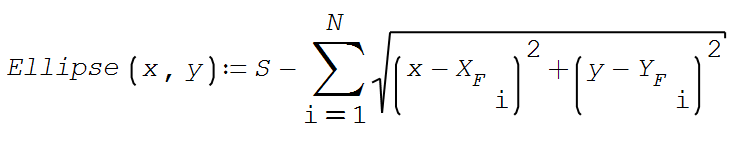

#6 Posted: 9/7/2023 1:43:13 PM
Valery Ochkov
Valery Ochkov
66 likes in 694 posts.
Better so

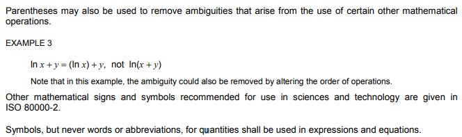

#7 Posted: 9/7/2023 2:24:15 PM
1,123 likes in 1,795 posts.
Better so ...
You can tell your students that you are using the Note under Example 3 of point 7.1.3 of ISO 80000-1:2009(E) Quantities and units, Part 1: General.

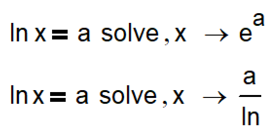

It if Mathcad 15
1 ln(x)
2 ln*x - why not
