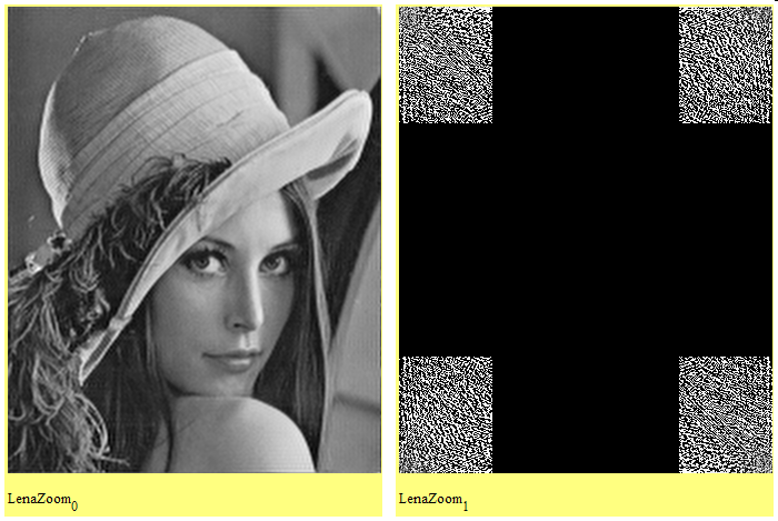

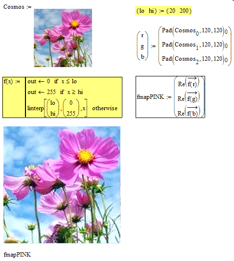

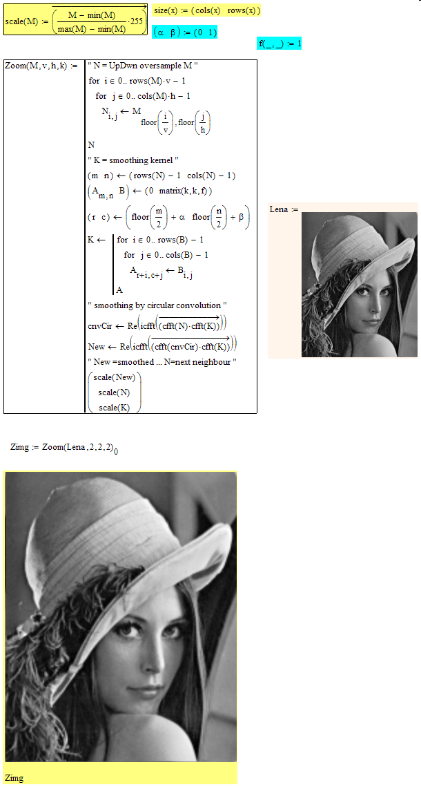

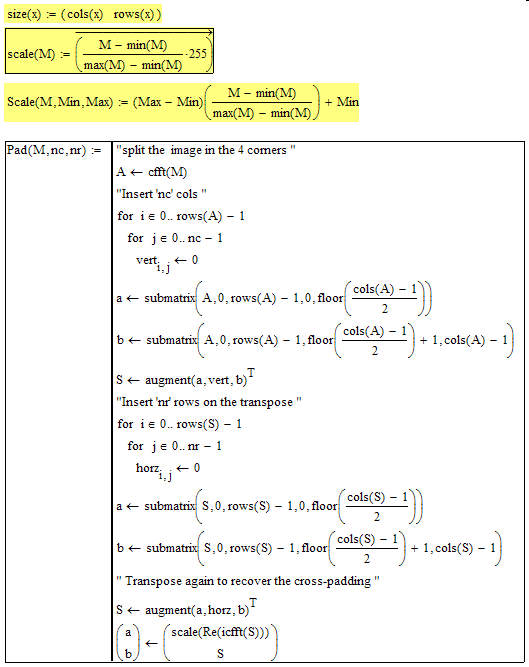

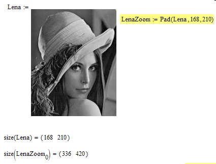

#5 Posted: 1/15/2016 1:45:39 AM
This is a wonderful idea for a "region" plugin. Now only if someone with enough skill decided to implement it.
Jean, can you create a list of the most desired functions of the "picture operator", together with maybe some MathCAD examples?
If anyone ever takes on such plugin (or modifies the existing image region) it can be a starting point.
____________________________
Alex, the fish is in the lake ... not in the mind. The actual Smath region is just an import command with
the additional place holder for name and highlight. Differently, the Mathsoft Picture Tool import/paste an
image as a "variable". As such it supports many natural Mathsoft matrix functions for image procesing +++
orientation, zoom, extract selected region, adjust contrast, superpose pixel coordinates markers. Additional
functionalities from the "Image Processing pack" are just supplementary math function already implemented
rather than to be designed.
No trace, no hint of the Mathsoft source code [pirated, reverse engineered ... ?].
I bet my last penny, Andrey could do it as well but ....
It starts by a peanut job: get the microsoft code that creates the screen image from the matrix
once you have the matrix, bingo: move into the maths. Actually Smath is short of processing to that end.
READ_IMAGE("string") - Creates an array containing a grayscale representation of the image file.
Maybe the start is there; for God sake how it works ?
Forgot to say that a clean graph imported from web or else screen display, can be digitized via
the Mathsoft little program. There is another free tool from the web.
