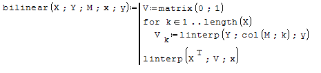

#2 Posted: 2/20/2014 5:09:03 PM
Thanks, Ioan,
the matrix(0,1) thing here is for those cases when V happens to be defined outside, thus being non-local variable. So here we effectively clear it (and ensure proper matrix type and dimension, while being empty). Otherwise, this may give unexpected results (if V is vector with more than length(X) rows), or errors (if V is not an array).
Other solution (though not bullet-proof) would be using some very strange and hardly-reusable name (like bilinear_local_V).
Yet another (and preferrable) would be a means to define V as local-only variable...

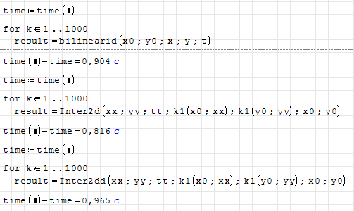

Here is a typical result on my computer (using your sample data). The results are consistently reproducible (±0.010s)
Notably slower is (surprisingly) Inter2dd, while Inter2d is steadily faster (though not that much faster - I suppose that further optimisation could give greater boost) than my variant. I wonder why these two almost identical functions work so differently in terms of performance?
I didn't test for corner cases yet. Also, larger tables should be tested as well.

#4 Posted: 2/20/2014 10:13:53 PM
As for me the fastest is bilinearid followed by Inter2dd...
Sometimes seems to me that performances are also affected by the position... if I place my InterBil on top or on the bottom of the list below I can see an high difference...

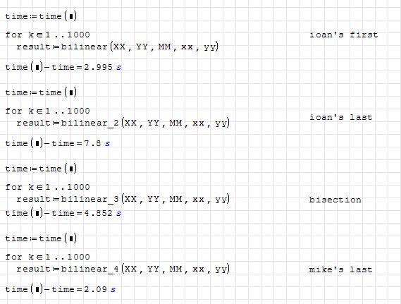

#13 Posted: 2/22/2014 7:53:47 AM
A test through the Margin() solutions... BTW IMHO is preferable a test with less iterations but bigger matrices...
[edit 1] file updated (previously missing xx and yy values on the canvas)
[edit 2] screenshot updated using the file above
![2014-02-23 02_48_16-SMath Studio Desktop - [bilinear-final i - mod.sm_].png](/en-US/files/Download/unGTxr/2014-02-23-02_48_16-SMath-Studio-Desktop---[bilinear-final-i---mod.sm_].png)
