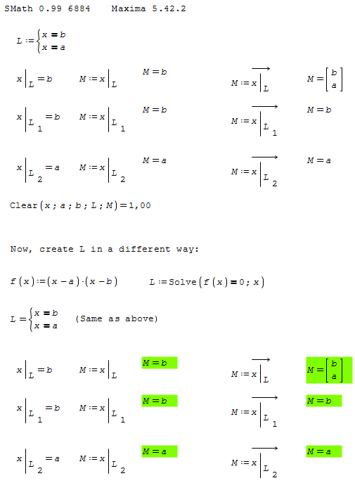

I starting with smath and still try easy examples.
Is found the results of at() to be inconstistent,
but it may be an bad understandig. Could someone review
my appended file?
Many thanks, Johannes

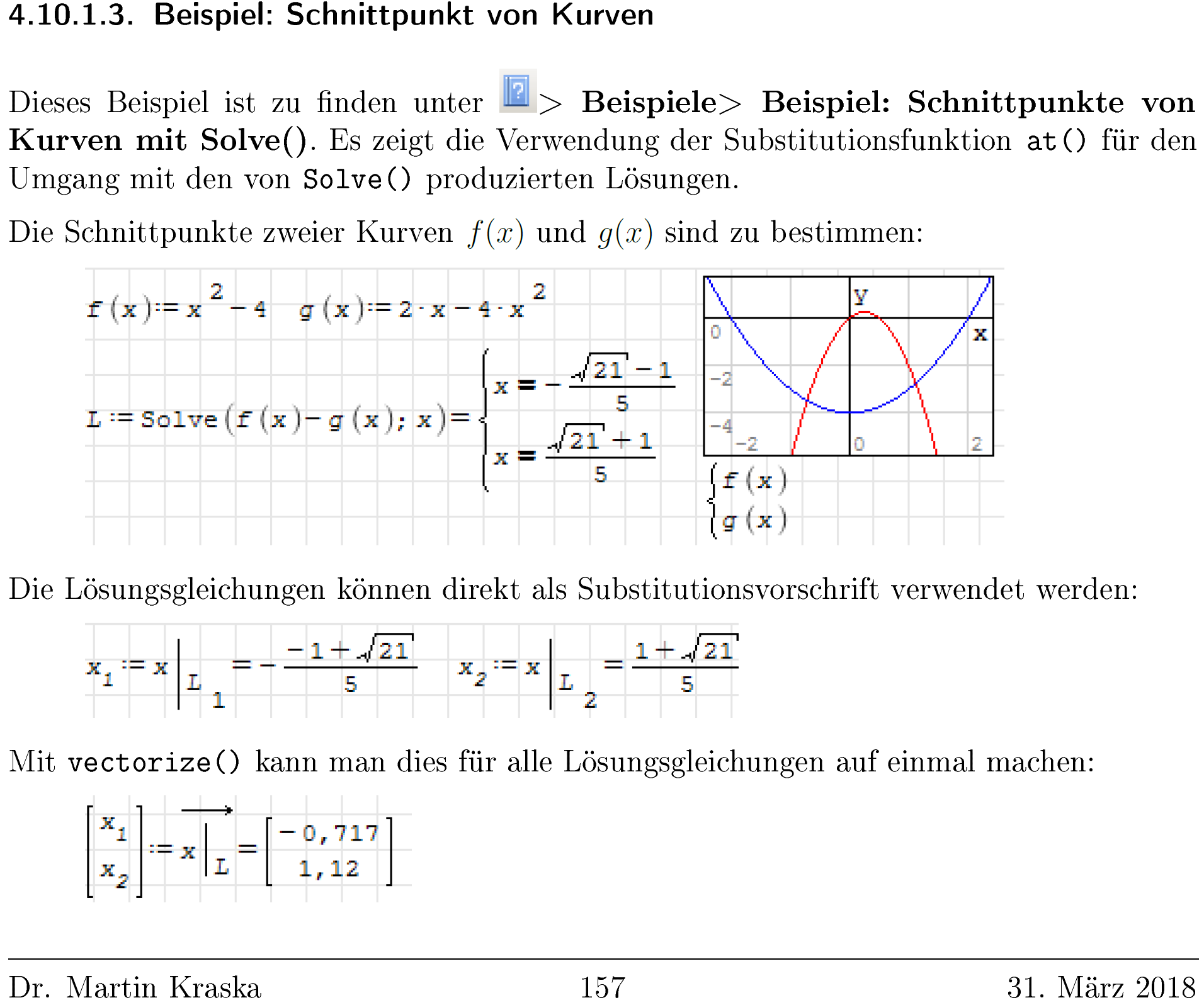

Bug in at.sm (20.62 KiB) downloaded 1358 time(s).

#2 Posted: 3/12/2019 7:08:03 AM
It is by design. If you give multiple replacement rules for the same variable ( x=a then x=b ) only the first is used (tbf there's no filter on how many times you can enter the same variable name on the LHS, thus the function tries even to evaluate x in b, but x doesn't exists anymore since is already evaluated in a)

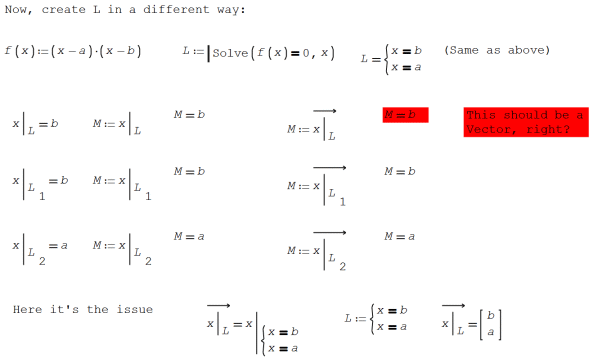

#3 Posted: 3/12/2019 7:12:20 AM
But why is it different for the two definitions of L?
Or does it look equal for you? (Than it may only occur for me.)

L is differently defined in the two versions (use the dynamic assistant by mouse hovering over the definitions to see the difference)
in the second case, L isnt't stored in evaluated shape, thus vectorize() doesn't recognise the expression as vector and executes the expression only once.

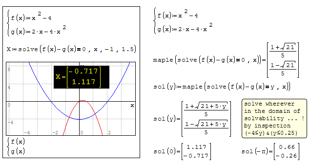

#9 Posted: 3/12/2019 10:35:02 AM

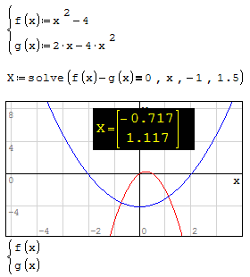

This is the numerical solution.
My question is about assignin symbolic results.

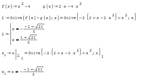

In the example you see mkraska using L:=Solve(,), and assigning the results.
In my try, you see the result is not assigned as expected,
last line shows
x.1= x=result
but it should be
x.1=result.

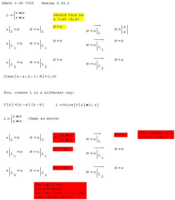

last line shows
x.1= x=result
but it should be
x.1=result.
#10 Posted: 3/12/2019 11:40:18 AM
#11 Posted: 3/12/2019 12:21:16 PM
It seems that the evaluation logic in the plug-in interface has changed.
The function Solve() indeed shows a different behaviour (not evaluated/simplified when used in definitions, as if it was behind a line operator)
Other functions like int() don't seem to be affected by the problem.
Blatt39.sm (6.81 KiB) downloaded 1426 time(s).
