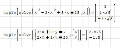

Thank you both for replies but I wonder what's the problem with my syntax. Why doesn't it work and how should I formulate the LinSolve or Solve function to solve such equations ? Or maybe that's the problem with Maxima plug-in ?

for simple parametric equations, you can use the integrated
solver without problem (solve with lowercase "s" )
and for Maxima Solve (with a capital "S" ) you must use the right button of
the mouse and select optimize symbolically, that is the only detail you are
missing to obtain the answer you are looking for.
If you want to obtain results, the 2 expressions in the image above must be
evaluated with symbolic optimization.
Solve gives you a result, but does not define "x"
that's why you get the error x undefined
you can use Assign so that "x" is now defined

Thank you very much, it works great now:
By the way, do you know how to convert these fractions to decimals ? I tried doing this from the menu available when clicking with right mouse button but it doesn't change anything.

fractions to decimal :
with numeric optime, but remember you firsth must declare x & y
with Assign command.
