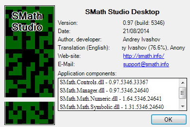

Hello E-Jay, what version of SMath Studio version are you using?

Version: 0.97 (build: 5154)
Date: 2/10/2014

I just tried to update the program. It did not appear to install the update.
I then removed the program and installed the latest version.
0.97 (build: 5346)
8/21/2014
