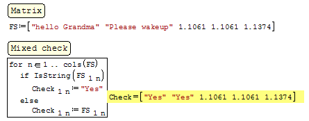

Why is it that within an if statement I can use a Boolean equal sign to compare objects to a number, but if I try to compare numbers to text I get an error stating that the action could not be performed with text.
See attached.

Ah yes, I should have been more specific.
It seems odd to me that the if you compare text to a number the Boolean decides that the text does not equal the number so it executes "as expected". However, if you compare a number to text there is an error thrown. Clearly the text is not the number so why not behave in the same manor?

#4 Posted: 3/7/2017 7:01:20 AM
Seems a bug to me. At first glance it happens only if the number in the comparison comes from el() and is not the first matrix element.
