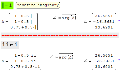

Can we have another imaginary unit?
an "i" with two vertical lines?
When I solve electric circuit problems I have to use "c" for current.
an "i" with two vertical lines ?
Like this Basile ... Cheers Jean
#3 Posted: 3/19/2023 5:09:09 PM
Basile.sm (3.66 KiB) downloaded 1228 time(s).

Thank you Jean.
I believe that a code solution is needed for i, π, e, etc.
Basile
You are correct, you shouldn't redefine some constants globally by editing a setting file.
Only option is adding variable defining codes to start of your worksheet.
