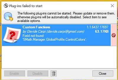

I am experiencing problem in installing CustomFunctions Plugin in SS 6520 (07/11/2017).
Even some items {(such as cases(), abs()}in the Function Index of Reference book have problems.
I am using Win 10 64 bit latest update.
Pl test the attached example.
Small Dams Flood Routing Ex-Program Method-Original-Simple3.sm (863.28 KiB) downloaded 1511 time(s).

#2 Posted: 11/8/2017 9:37:35 AM
Confirmed as well,
NDTM Amarasekera 11/9/2017 11:47:00 PM
#3 Posted: 11/8/2017 3:49:41 PM
Thank you, I'll fix it ASAP. As usual please be patient and keep reporting issues
#4 Posted: 11/9/2017 8:57:09 AM
They might be related to the new rendering system. I miss the issues with abs() (not related to CustomFunctions, though), could you post a screenshoot? Thanks in advance.
