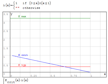

![2022-03-21 22_18_08-SMath Solver - [SpecialPlotsBug.sm_].png](/en-US/files/Download/ZRkZwF/2022-03-21-22_18_08-SMath-Solver---[SpecialPlotsBug.sm_].png)
Is there any use case, where the original if() is better than the one defined with cases()? If not, then I propose to include re-definition of if() in the custom functions plugin.

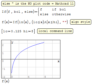

Bolean bug(s) are user bug.
Many projects will accommodate either style if/else ... if/otherwise
A long suite of conditions is horror if/else.
Doctor your plot 1 as proposed, press F9
Integrate Discontinuous_1.sm (24.57 KiB) downloaded 1599 time(s).
Integrate Discontinuous.sm (36.51 KiB) downloaded 1644 time(s).
Integrate Discontinuous_2.sm (132.47 KiB) downloaded 1640 time(s).

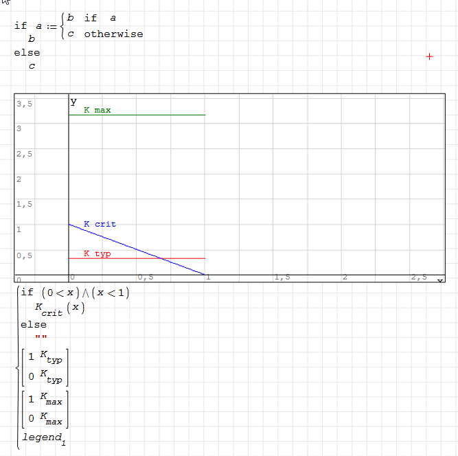

... doctored for convenience.
Observe collected plot, easy to manage.
Cheers ... Jean.
SpecialPlotsBug DOCTORED.sm (10.86 KiB) downloaded 1622 time(s).
Cheers ... Jean.
