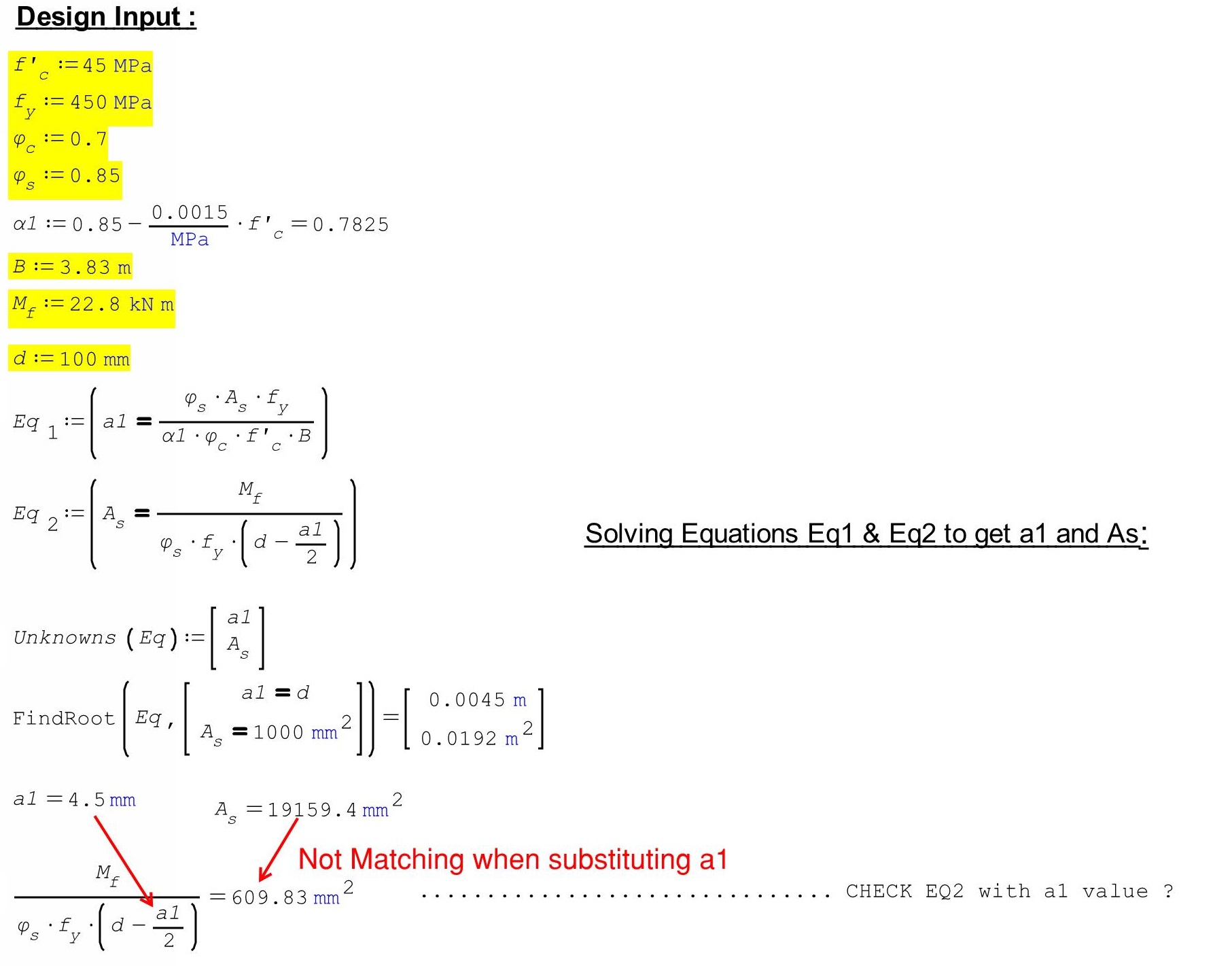

I was trying to solve 2 equations and getting the root using FindRoot with weird results, that when substituting with the SMath results the equations don't yield to the same results.
I know using units seem to create problems, but it sometimes works and I need to solve this somehow.
any suggestion?

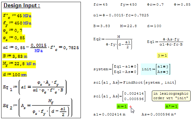

#3 Posted: 5/4/2019 7:01:20 AM
Somehow it works better reversing the unknowns... dunno why...
Also since you are working with units you have to pay attention at the required precision. The one shown in the function description is about the base units, m for the length and m^2 for the area.
Test - r0.sm (277.65 KiB) downloaded 1198 time(s).

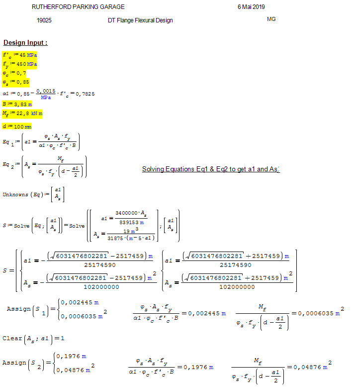

If using the Maxima plugin is an option for you, then the solution is straightforward.
- Units are no problem for the plugin (they are converted into symbolic variables, Maxima itself isn't unit-aware).
- Multiple solutions are returned by Solve as a row vector of solutions (with each being a list of equations). You can pick the solution by
index and apply it using Assign().
I don't know how you can know in advance which solution to use. Perhaps the reasoning on which one to select can be cast into some test for index generation.
Best regards, Martin
