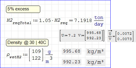

I have a figure that is mass flowrate & I have a matrix with x2 volumetric densities. I want to divide former with the latter to get x2 different volumetric flowrate. How should I proceed given I cannot simply put Matrix in divisor
Screenshot
https://prnt.sc/JVkxiL50fw46

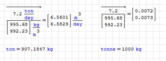

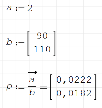

#2 Posted: 4/9/2022 11:46:37 AM
127 likes in 342 posts.
Use the "vectorize" function (you also find it in the right panel)
#3 Posted: 4/9/2022 3:15:23 PM

Please be very careful with this type of calculations with false units without any sense, as they can lead to fatal accidents.
#5 Posted: 4/10/2022 10:23:50 AM
Splendid remark ! because no project description.
As given T/day, add g/m³ of H2 at two different °C
#6 Posted: 4/10/2022 10:31:05 AM
599 likes in 1,381 posts.
Very nice and considerable advice.
Some so-called expert engineers can't even use units.
Expecting them to use correct and proper one is futile effort.
#7 Posted: 4/12/2022 7:55:16 AM
usamakhan
usamakhan
7 likes in 96 posts.
Thanks for the replies everyone...
Yes Ton / Tonne difference is important & I have corrected it in my calcs
