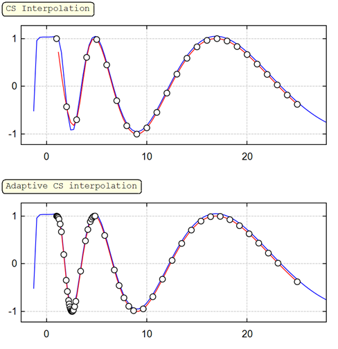

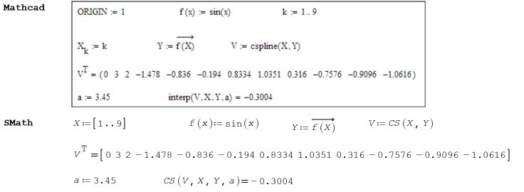

Hi Jean. There are not to much shadow in that small code. It's just the implementation of the traditional spline interpolation. In SMath there are not, or I can't found, the function cspline. The interpolation with cinterp in SMath evaluates the vector V each time that you call it, it's always better to have V=cspline(X,Y) and then call interp(V,X,Y,x). Finally, I want to implement an adaptive step size for the intervals in X. But first I see very convenient to have vectorization and plotting issues solved.
CS only do what mathcad's cspline do:

CS only does what Mathcad's cspline does:

CSplines with adaptive steps. Same issues, but now can use zero with units, at least in the adaptive case.
adapt cspline test.sm (83.25 KiB) downloaded 1333 time(s).
