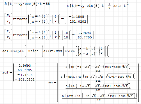

Hi Sergio. There are a 3 argument version of roots, where the third is a guess value for the root.
Roots.sm (9.84 KiB) downloaded 1279 time(s).

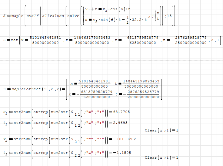

Here your solution solved with maple plugin.
No need to enter guess points for this.
Maxima can solve it too, similarly.
PS: MapleCorrect() function can be found here.
Assign() function can be used instead of str2num() + num2str() + strrep().

Hi. This is another way.
Roots.sm (16.66 KiB) downloaded 1229 time(s).

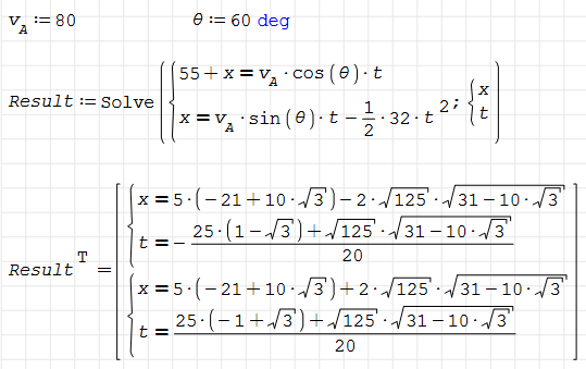

598 likes in 1,380 posts.
I found a Windows laptop.
And tried Maxima plugin Solve().
It can solve easily.
