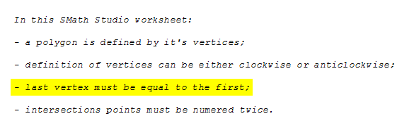

#7 Posted: 7/1/2019 5:29:57 AM
1,443 likes in 2,935 posts.
Does it work as well for open polygon ?
Nope, this worksheet was made just for closed polygons.
