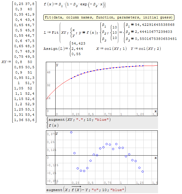

Let's rename from reworked previous document.
Please comment/else on
that document *.sm Copy/paste from sources aren't enough compatible with SS.
The model function is excellent. In fact, the conclusion is
in the reverse common understanding, i.e: thickness vs temperature.
The InverseFunction is given => find thickness given temperature.
A superb project, maybe checked again.
Thanks Elsid, most appreciated ... Jean
