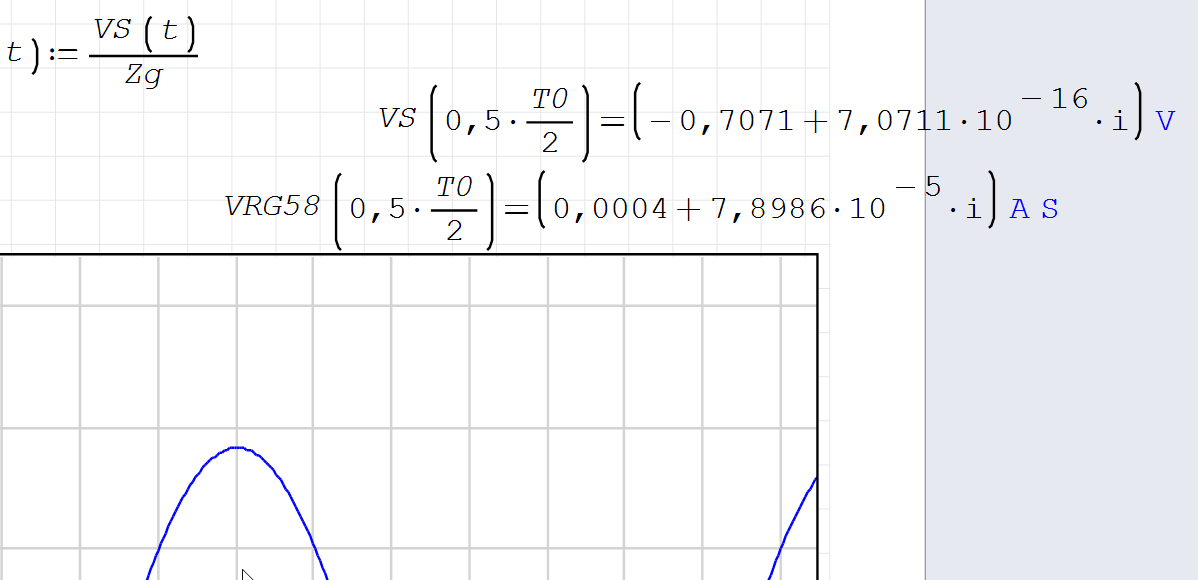

unfortunately, I can't find the error myself. Why VS(t) and VRG58(t) work well, but V1(t):=VS(t)-VRG58(t) not?
Regards Andreas
Auszug.pdf (114.69 KiB) downloaded 376 time(s).
Auszug.sm (16.52 KiB) downloaded 496 time(s).
#2 Posted: 5/9/2026 9:14:00 AM
127 likes in 342 posts.
It seems that the two quantities have different units of measurement.

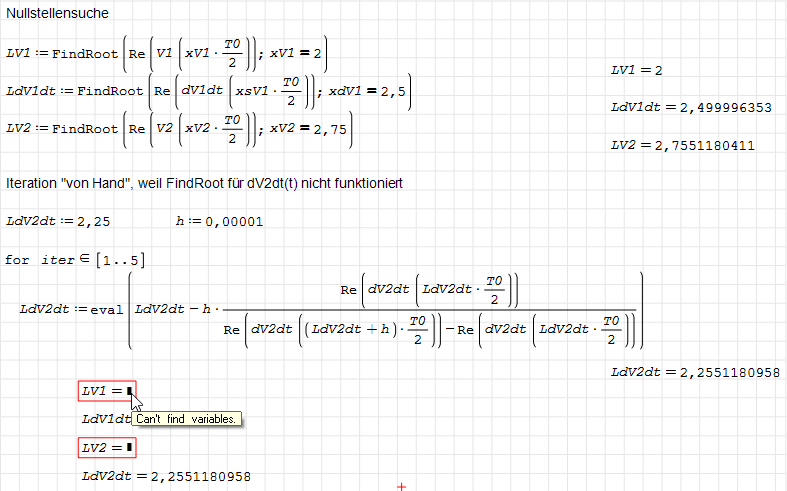

#7 Posted: 5/12/2026 1:09:32 PM
Andreas Beldowski
Andreas Beldowski
0 likes in 17 posts.
It's me again, with a new problem.
Why doesn't the last line work, when the four lines above it do?
Versuch mit R und C mit Oszi Auszug.gif Versuch mit R und C mit Oszi Auszug.pdf (910.43 KiB) downloaded 324 time(s). Versuch mit R und C mit Oszi Auszug.sm (130.35 KiB) downloaded 481 time(s).

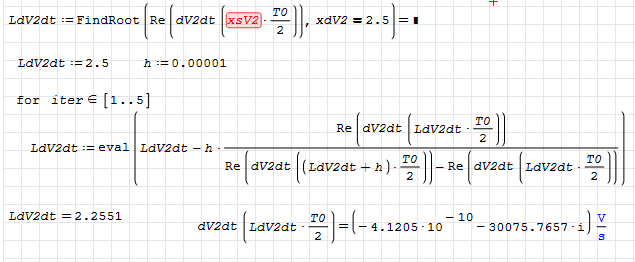

#8 Posted: 5/13/2026 2:13:04 AM
1,139 likes in 1,805 posts.
Hi. I have no idea why it fails, however this may be a workaround, consisting of directly applying the Newton-Raphson method.
Versuch mit R und C mit Oszi Auszug.sm (121.16 KiB) downloaded 463 time(s).

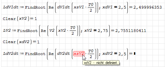

#9 Posted: 5/13/2026 5:47:01 AM
Andreas Beldowski
Andreas Beldowski
And why can I only use the values for LV1 and LV2 once, but the values for LdV1dt and LdV2dt multiple times?
I had already deleted the `clear()` statements, but that wasn't the problem.
Edited 5/13/2026 5:48:52 AM
#10 Posted: 5/13/2026 9:41:38 AM
Hi. Use eval:
