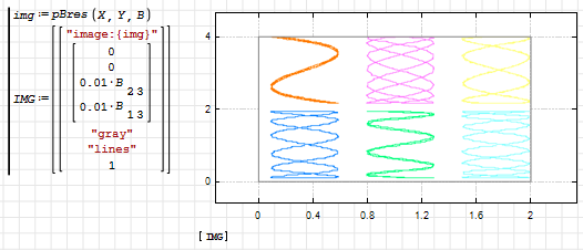

#5 Posted: 1/3/2025 12:21:22 PM
1,139 likes in 1,805 posts.
Second life: now it can be inserted into an XYPlot.
BresenhamPlot v3.sm (72.72 KiB) downloaded 1799 time(s).
BresenhamPlot v3.pdf (320.81 KiB) downloaded 1196 time(s).
