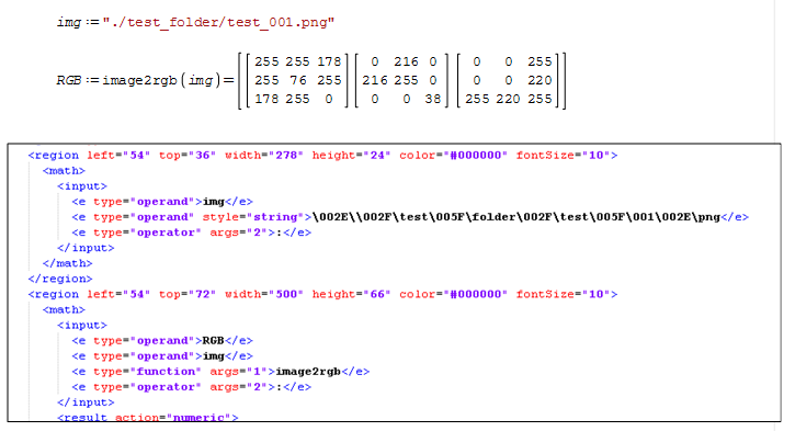

Hi. The error is self explained.
This is the saved file:
Davide Carpi 4/22/2021 8:36:00 AM
#2 Posted: 4/22/2021 8:36:07 AM
Thank you, I'll fix it ASAP.

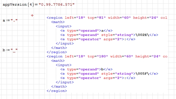

#3 Posted: 4/25/2021 7:48:26 PM
Fixed and released for the latest beta
Alvaro 4/25/2021 8:09:00 PM
#4 Posted: 4/25/2021 8:21:10 PM
1,139 likes in 1,805 posts.
Hi Davide. The issue persists for release "0.99.7786.571":
test.sm (2.38 KiB) downloaded 1449 time(s).
#5 Posted: 4/26/2021 4:38:06 AM
It works for me even if dots, slashes and underscores are encoded

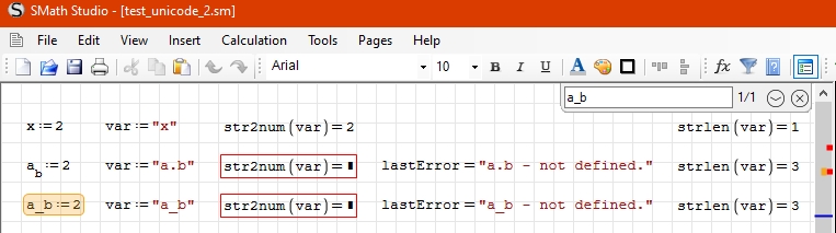

#6 Posted: 4/26/2021 8:53:32 AM
Hi Davide. Yes. you're right, it works with encoded strings now, I see the strings, and no check if can read files with that.
So, standard ASCII characters lower than 128 will be encoded as Unicode? That can introduce a lot of issues for low level manipulation to the user.
test_unicode_2.sm (5.82 KiB) downloaded 1504 time(s).
Also, the string "a_b" doesn't appear in the search box, but if you search for x, x and "x" appear.
Also, suppose that I want to find an sm file where it's defined the function "my_function_1": I need to search now the string "my\005F\function\005F\1" inside the files?

#8 Posted: 4/26/2021 11:38:33 AM
2,343 likes in 4,055 posts.
Alvaro,
Thank you! Fixed.
