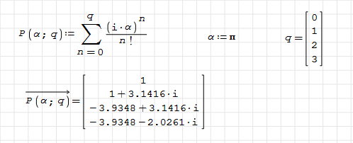

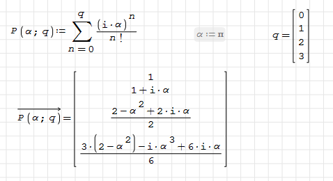

#2 Posted: 7/5/2023 5:55:59 AM
apha undefined + symbolic optimization
apha define + numerical optimization
