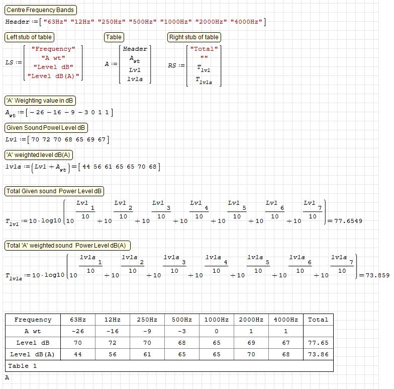

Hi All,
I am trying to work out the 'A' weighting values for sound levels, I have the calculation working, but I would like to simplify the total power levels, by either summation or a loop function. I know how to use summation, but cant get it to work on this.
acoustics 1.sm (17.98 KiB) downloaded 1071 time(s).

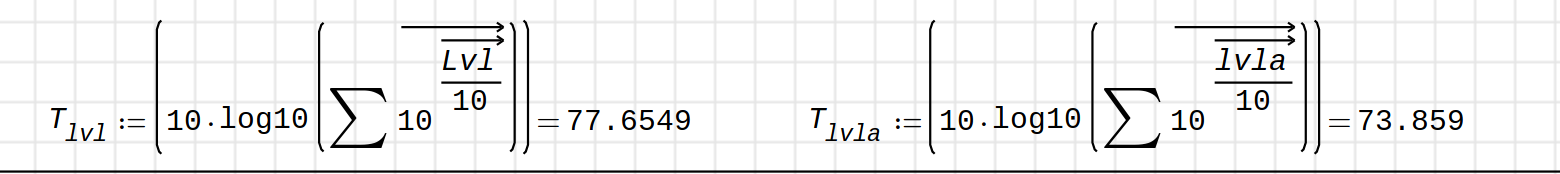

How's this? Using vectorize() function to apply operations to each element in a matrix.
Show Spoiler
acoustics_lyles.sm (14.86 KiB) downloaded 1061 time(s).

Hi Alyles,
That was exactly what i was looking for thank you.

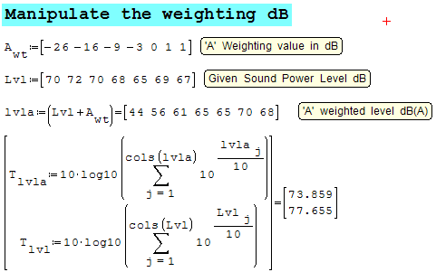

alyles,
maybe there's an excess of vectorization
frapuano 10/20/2019 4:37:00 PM, Arie 10/20/2019 4:48:00 PM
