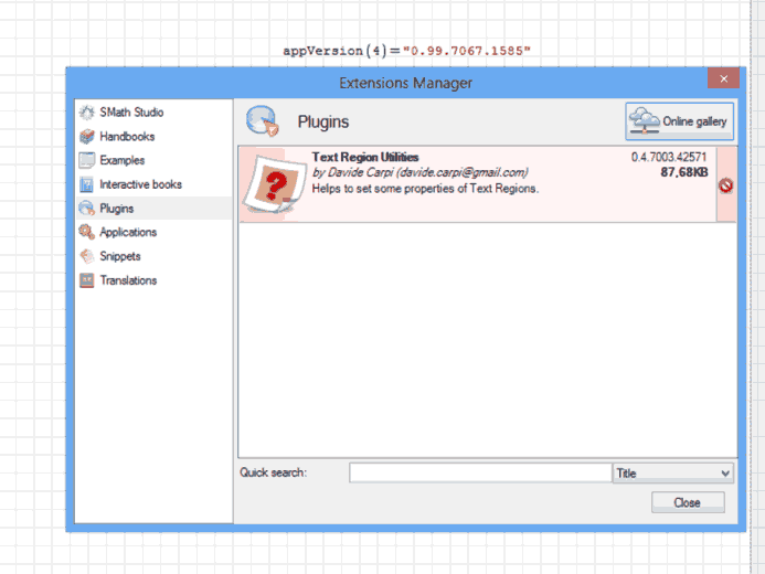

Text Region Utilities Smath Studio 0.99.7067.1585 - The region text utilities fail when installed in Smath Studio "0.99.7067.1585" - Messages

#2 Posted: 5/24/2019 3:03:31 AM
1,443 likes in 2,935 posts.
Thank you, it is related with a change in the API and should be fixed in one of the next SS releases.

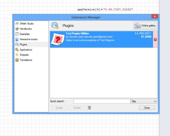

Hello Davide.
The new released version of Smath Studio 0.99.7057.32292 has the same problem as
the previous version 0.99.7067, and does not accept the Text Region Utilities plugin.
#4 Posted: 5/30/2019 1:24:29 PM
2,343 likes in 4,042 posts.
Fixed in latest beta (just released).

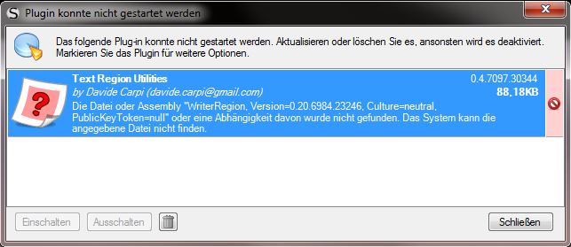

I just installed the latest beta (0.99.7100). I still get the message, that "Text Region Utilities" can not be startet.
It also did not work in the beta (0.99.7097).
System: Windows 7 x64
The program keeps telling me that "The file or assembly 'Writer Region, Version=0.20.6984.23246, Culture=neutral, PublicKeyToken=null' was not found."
#7 Posted: 6/18/2019 8:52:36 AM
do you have the latest Writer Region installed? (WR 0.20.7097.27665 in SS 0.99.7100)

Thank you very much for the advice.
After reinstalling the Writer Region Plugin (now 0.20.7079.27665) everything works.
