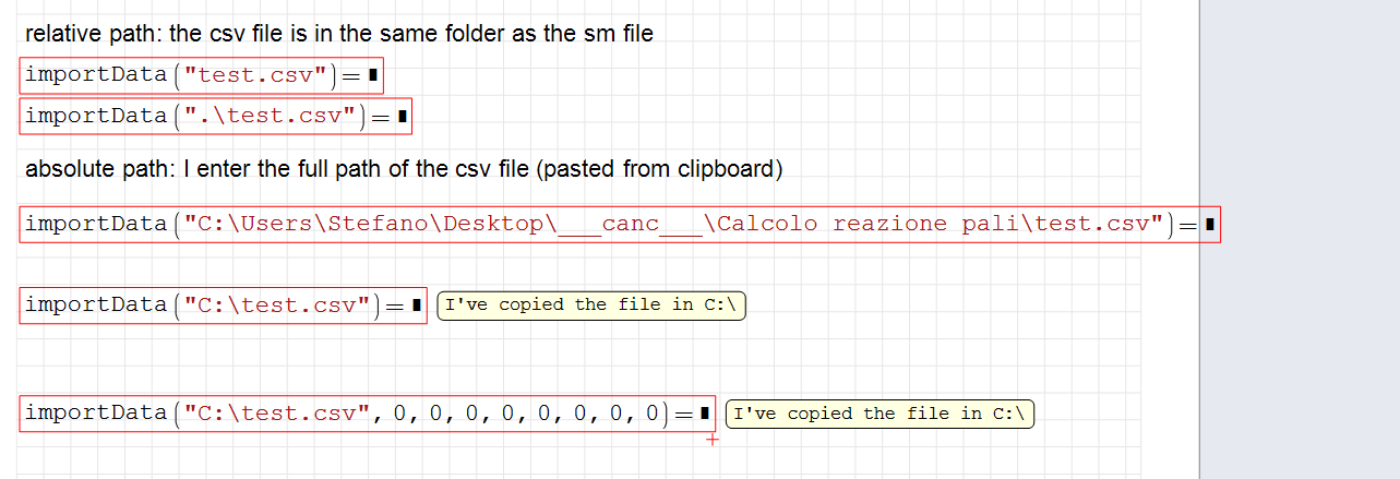

I have some trouble understanding how to use importData() function.
I get these type of errors:
  • "file does not exist" if I try a relative path
  • "input string is not in a correct format" if I try a absolute path
I am at loss, I don't understand what is not working
on win10
smath studio version 0.99 vuild 7921

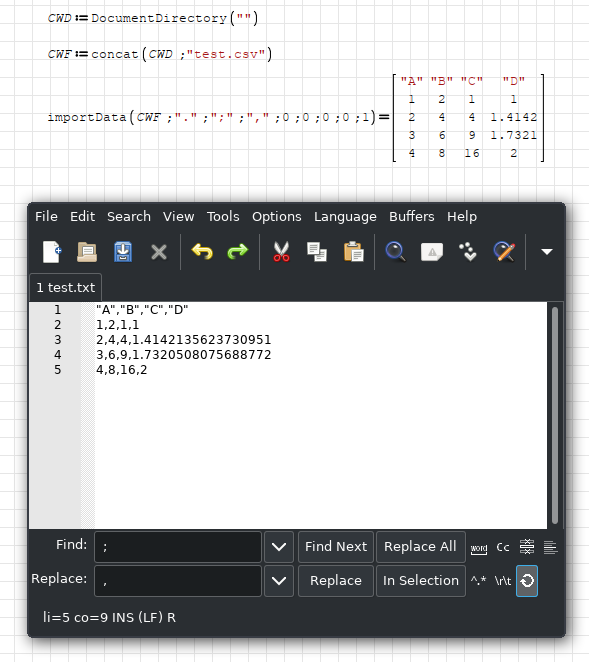

#3 Posted: 1/26/2022 5:45:52 PM
1,094 likes in 1,766 posts.
Hi. The attached shows that overlord's it's the best solution, but also that there are an issue somewhere, its cause is very hidden to me.
TEST.sm (305.05 KiB) downloaded 1234 time(s).
TEST.pdf (904.59 KiB) downloaded 736 time(s).
