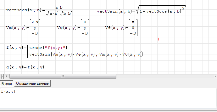

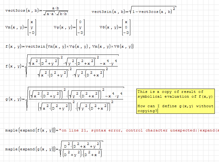

Sorry, have not found the answer. Attached is a sample with two functions f(x,y) and g(x,y).
In the sample I have just copied the result of symbolical evaluation of f(x,y) to g(x,y). How to perform this assignment directly? I need g(x,y) to be updated if input vectors change.
Easy to see that symbolical evaluation does not change f(x,y). Maple can undestand g(x,y) but not f(x,y).
#4 Posted: 5/3/2017 1:30:19 PM
... just assign like this g(x,y):=f(x,y)
shown in red Smath 6179 attached.
Does it work for you ?
testassign.sm (16.83 KiB) downloaded 1174 time(s).

maple() function doesn't understand smath cross product symbol. It is not supported in the current version.

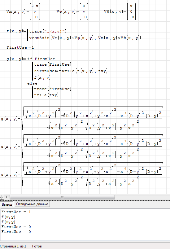

#7 Posted: 5/3/2017 4:57:46 PM
1,361 likes in 2,275 posts.
This works.
testassign_Kr.sm (17.97 KiB) downloaded 1128 time(s).

#8 Posted: 5/3/2017 10:26:26 PM
no, it does not work. It assigns original f(x,y) to g(x,y) and not symbolically evaluated, see blue fields in attachment
The blue is just maple()simplify(...)

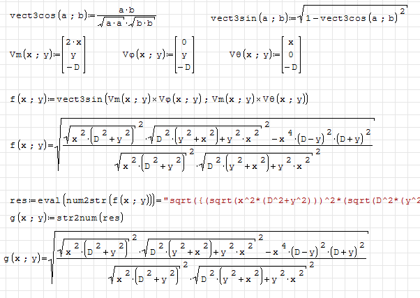

#9 Posted: 5/4/2017 1:34:25 AM
1,558 likes in 1,868 posts.
Something like this?
#10 Posted: 5/4/2017 11:08:56 AM
avanturist
avanturist
2 likes in 9 posts.
Thanks to Martin and Viacheslav for working solutions!
As I understood, there is no regular way in SMath to access already existing result of symbolic evaluation. The solutions are tricks to export the result to string/file and to import it back.

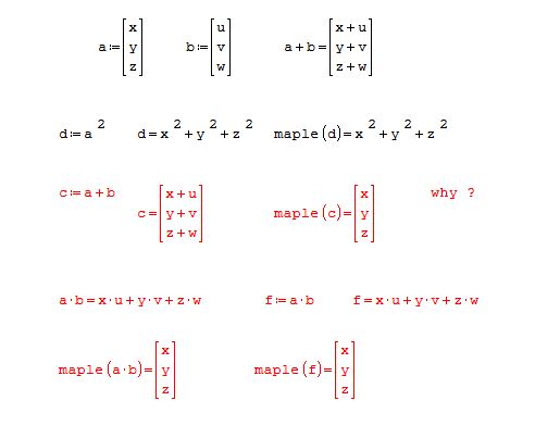

#19 Posted: 5/6/2017 4:20:38 AM
I might be wrong here, but I think the question is about something like this regarding maple.
If you can not reproduce this, there might be something wrong with my SMath.

#20 Posted: 5/6/2017 6:32:36 AM
This is bug in maple() function. Not all operations are performed correctly during the conversion.
