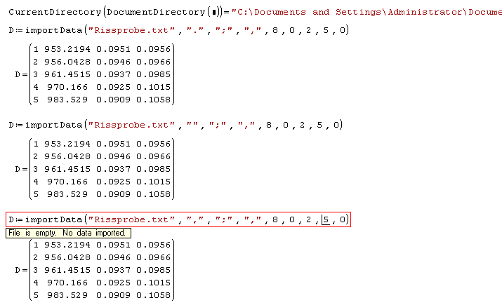

I want to read a text file using ImportData() and can't understand the effect of the dec separator setting (second argument)
The first version with correct specification does not work.
The other versions with default or wrong specification do work. But they don't work on some other computers.
This is the contents of the file:

As this might largely system dependent, I would like to get this tested by others before committing a bug report in the bts

#2 Posted: 3/27/2015 10:49:41 AM
1,442 likes in 2,933 posts.
Same result as your if I use comma as decimal separator and semicolon as argument separator
the result below is if I use period as decimal separator and comma as argument separator
Show Spoiler
