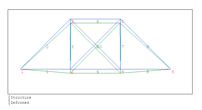

#1 Posted: 9/9/2017 12:05:32 PM
Hello I attach here a worksheet for the FEM analysis of 2D trusses, it has to be tested!
Truss FEM.sm (328.7 KiB) downloaded 1539 time(s).

#3 Posted: 9/10/2017 5:44:22 PM
Hi LORENZO,
Here is FEMTRuss, my own version of truss calculus via FEM.
I'll check your work, please you check mine

#4 Posted: 9/11/2017 12:46:07 AM
So far results look good. Great work!

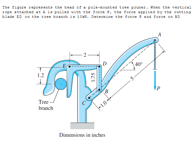

#6 Posted: 9/11/2017 5:26:48 PM
WroteThe only thing I understand in there is the construction.
A little example solved by FEM...
P4-118 Pytel modified.sm (165.01 KiB) downloaded 1484 time(s).
