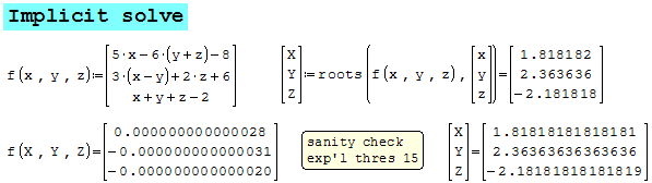

I have to solve a non-linear system of 6 equations and 6 unknowns and wanted to know which function is best suited to solve it.
The right answer is: give the system ... there are many ways.
Solve Algebraic.sm (73.6 KiB) downloaded 1107 time(s).
Solve Algebraic, NON-Algebraic.sm (176.51 KiB) downloaded 1060 time(s).
