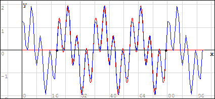

Hi. This function emulates the matlab filter function (https://uk.mathworks.com/help/matlab/ref/filter.html) Hope it's helps.
filter.sm (34,81 КиБ) скачан 1140 раз(а).

sergio 05.11.2019 12:49:00
... lot more smoothing in there.
filter.sm (49,5 КиБ) скачан 1131 раз(а).
