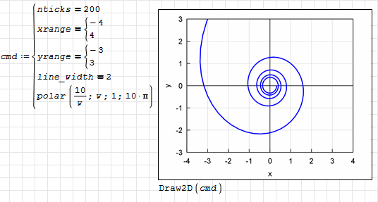

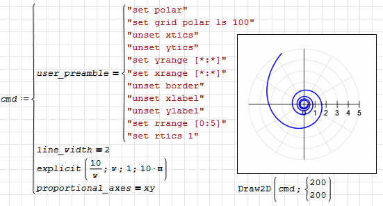

This is how it can be done using Maxima. Full flexibility is gained using direct gnuplot commands.
Draw2D3D-EN.sm (1017,89 КиБ) скачан 1701 раз(а).
SMath with Maxima.pdf (3,5 МиБ) скачан 4584 раз(а).
