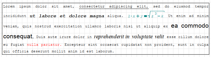

I'm a long time user of SMath and I think it's amazing.
My background is electrical engineering and Smath has replaced excel as my go to software for doing engineering calculations and reports. Everyone else I know in the industry all use excel to do their calculations and then they copy the results in a word document to create reports. Obviously this is extremely inefficient as inevitable changes in inputs results in having to re-write reports.
The main features I need to produce professional looking reports though is rich text formatting and spell check. Because of this, I use the "Writer Region" plugin by Davide Carpi for all text and never use the standard "Text region."
I thought I'd throw it out there and see if most people would agree to integrate "Writer Region" to replace "Text region" or add all of the features of "Writer Region."

#4 Опубликовано: 11.02.2023 10:21:30
Hello Andy.
Ordinary text from " keyboard is mostly reserved
for project complementary notes as needed to explain.
Lovely for abstract scientific style.
Writer Region is more advanced,
splendid to highlight parts of project.
But too much when not needed, IMHO.
Both styles Text & Writer accommodate
inserting live maths project inside the region.
Very convenient as it may resume pages of project.
Simply complementary companions at will.
Cheers ... Jean.

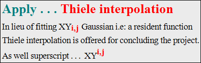

#8 Опубликовано: 16.02.2023 09:24:28
Writer Region SS 6179 supports subscript/upper-script.
