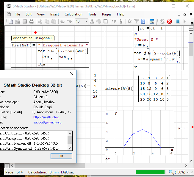

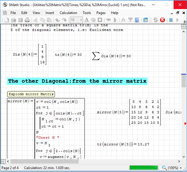

A peculiar thing happened to me with your second file and the recent SMath (Win 10 32bit). It just do not stops calculating and I do not have a clue what is going on. Here is the screenshot:
I Do not know where did it stop (see the blue line at the slider, the red square is wrt diagonal of nonsquare matrix error diag2vec() function). There is no green border around any region as well.
Blue slider stopped there and and after about 40 min SMath crashed.
Does anyone can reproduce this? If so, there must be a recently introduced bug then (with for loops maybe).
EDIT: Actually, it did well when I put the Optimization Numeric to all regions, except to the diag2vec() function

The little red square in both snippets point to the module diag2vector(M)
One of them [the second one] that was coded for error"matrix must be square"
it created a "critical error occurred" ... remove this module as in fact it
is useless and the definition incomplete. It must be coded
out:= error"matrix must be squared".

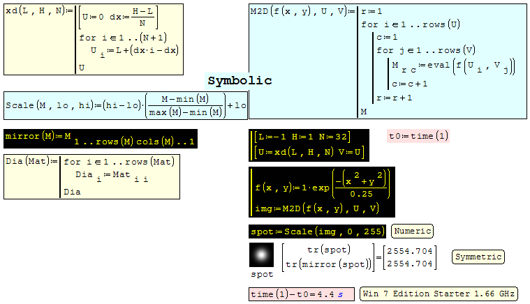

The three attached work fine after some doctoring. If your Smath crashes again,
must be examined more closely.
Utilities Matrix [Times, Dia, Mirror,Euclid].sm (28,47 КиБ) скачан 1097 раз(а).
Utilities Matrix Delta.sm (33,81 КиБ) скачан 1238 раз(а).
Utilities Most used [2D f(x,y)].sm (13,22 КиБ) скачан 1032 раз(а).
There are several methods can be used to detect where is the issue:
1) See what region has green border. In this case it will not work because of black background set for some regions (it is hard to see green border for regions with black background).
2) Press Pause button on the toolbar (usually it will show an exact region where calculation currently in progress). In this case it will not work as issue is inside of the plug-in.
3) Hover the progressbar by mouse to see tooltip like "64 of 67 regions processed", which means that issue is in the next evaluable region after 64. In our case one can see that issue is at the end of the worksheet.
4) Press Interrupt processing toolbar button to see what region will be marked as red (approximate place will be also shown on the vertical scrollbar).
So, using (3) and (4) one can see issue is in N:Scale(N,0,255).
Hope this will help to make investigations in future.

I suspected that the problem must be at somewhere at the end (but deliberately did not want to change anything in the worksheet). The simplest for me, and maybe for other users, was to make the regions Optimization->Numeric - in most cases when SMath get stuck, it helps. If that did not work I will definitely see where the problem was (in spite of rather hard to notice green borders in the black background regions).

Radovan, try this one ... works fine.
Utilities Most used [2D f(x,y)].sm (48,04 КиБ) скачан 1072 раз(а).
