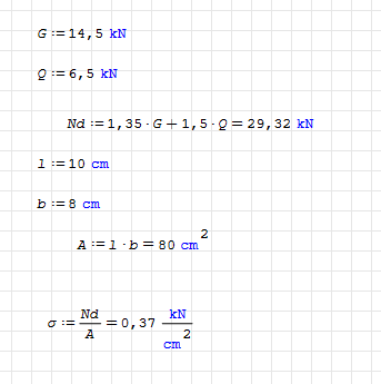

I would start out by saying that you might want to read through some of the instructions first.
There is already lots of info about how to use SMath. This is a very basic part of SMath.
For your issue specifically:
After you define X:=A*B and press enter, it will produce the default unit of m^2
You need to click on the entry and you will see a second black units box after the default m^2 one.
Click in this box and then just type in mm, press tab to insert unit, then type ^2 to make it square.
You can change the units on any result by doing the same thing as long as they are equivalent units.
Good luck.
Good luck.
#3 Опубликовано: 4 года назад
I might add that you need to press tab to insert each unit.
So for kN/m^2, you need to type in kN, press tab, then type / and then type in m and press tab, then type in ^2 to make it square.
