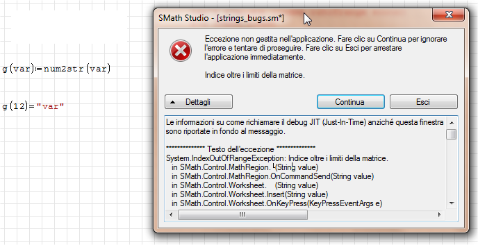

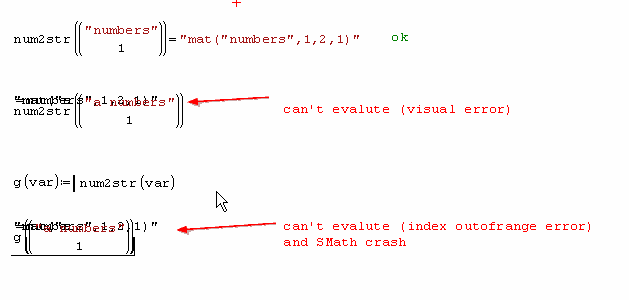

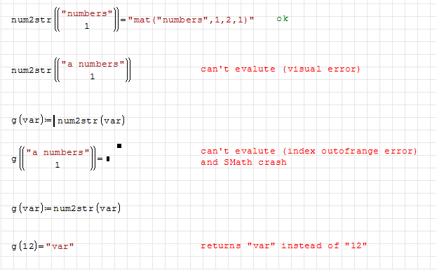

- num2str() returns critical errors when inside matrix there are strings with spaces
regards,
w3b5urf3r

you're right, the crash happens only in some conditions...
1) enable and underline the g(...) function (or the num2str(...) function)
2) try to move the underlined evaluated function
3) when you relase the function, if a white rectangle appear, press the spacebar
4) click on the "exit" button in the error message and SMath becomes "freezed"
the crash is probably a non-issue because it is a consequence of a previous bug
regards,
w3b5urf3r
#4 Опубликовано: 03.05.2013 18:11:32
1 244 сообщений из 2 167 понравились пользователям.
In version 0.96 num2str still cannot handle expressions which contain strings with spaces.
