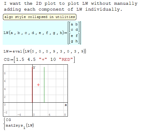

hi,
I am trying to create a sheet to design welds and want to plot the geometry of the weld lines.
the problem is if I assign a matrix with x,y coordinates the 2D plot will draw a continuous function connecting all points, and when I assign this to a discrete matrix of line coordinates it does not plot unless I assign each line individually which is bad as I want it plotted based on the geometry.
in the example below, I want the 2D plot to plot LW without manually adding each component of LW individually.
#2 Опубликовано: 08.11.2022 15:18:08
One possible options mat2sys.1() function.
test_alyles.sm (35,91 КиБ) скачан 1161 раз(а).

#4 Опубликовано: 08.11.2022 16:20:38
... make it algo style. CG can be managed as well.

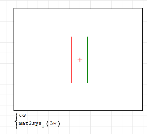

#5 Опубликовано: 08.11.2022 16:51:40
... it may be possible to make svg [Scale Vector Graphic].
test_alyles & jean.sm (41,37 КиБ) скачан 1155 раз(а).
#6 Опубликовано: 08.11.2022 20:36:11
... this is NOT a graph. It is an image triplet.
1. You can size the thickness/magnitude of the CG
2. You size length/thickness/color of the side welds
3. re-dispose the final triplet.

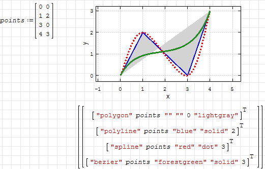

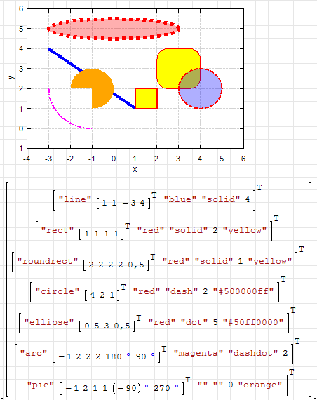

#8 Опубликовано: 09.11.2022 05:42:29
You might consider building geometry plots from the pre-defined objects in the XY-Plot-plugin.
sergio 09.11.2022 07:36:00, NDTM Amarasekera 09.11.2022 09:42:00, Arie 09.11.2022 09:42:00, Alvaro 09.11.2022 18:32:00
#9 Опубликовано: 09.11.2022 18:34:13
1 123 сообщений из 1 795 понравились пользователям.
You might consider building geometry plots from the pre-defined objects in the XY-Plot-plugin. ...
And maybe you may be interested in this other Martin' post, if you want to draw steel profiles to be welded, and by the way calculate their mechanical parameters: https://en.smath.com/forum/yaf_postsm78221_Split-Areas-Polygons-convex-and-concave--by-lines.aspx#post78221
