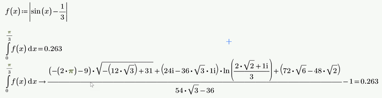

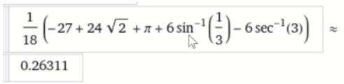

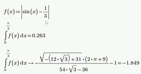

Why SMath studio does not give at least the correct result which is 0.263 for this integral?
Mathcad Prime 10:
-1.849 result is comming from symbolic result calculation, which is wrong in this case, but numeric result 0.263 is correct here also in mathcad prime 10.
Mathcad Prime 6:
SMath Studio:
Wolfram mathematica:

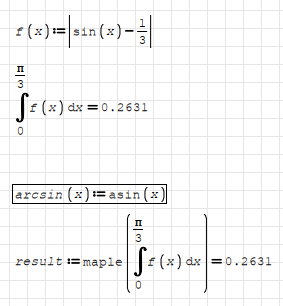

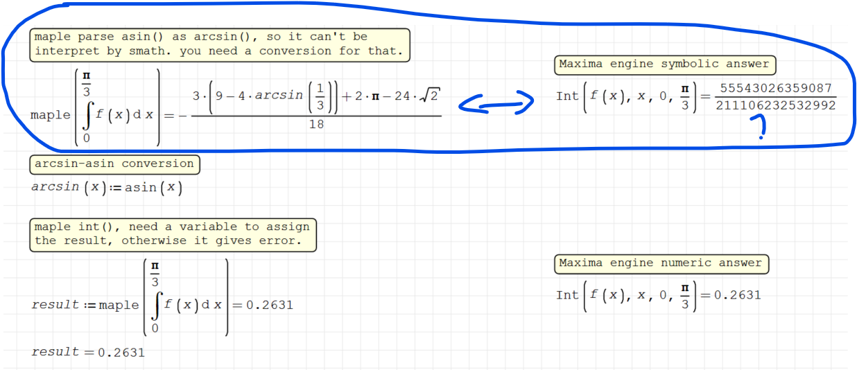

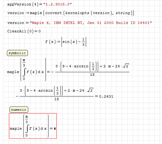

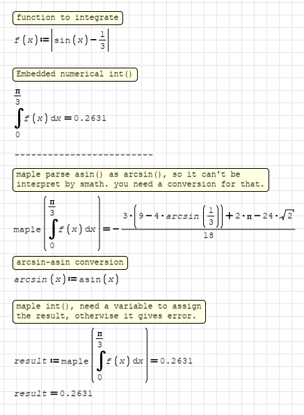

You must clear previous results (implicit definitions). If you do not, the task statement may change. To be sure, do each check separately in a new document.
maple-int-arcsin.sm (7,66 КиБ) скачан 1591 раз(а).
#4 Опубликовано: 14.10.2024 18:47:14
It gives correct results, even with embedded or maple.
You need to change arcsin() function to asin() however.

Could you post also the worksheet? As I do not know why my function arcsin(x) definition is not taken into account
Here it is, regards
int-embedded_maple.sm (6,97 КиБ) скачан 1581 раз(а).

I tried to run this worksheet, and was asked to install Maple Tools. I tried to do this twice and both times, SMath crashed during the install - just vanished into the thin electron cloud, without so much as a goodbye or reason for leaving.
This is on a fresh install of SMath on a new Windows 11 PC that has never had SMath installed before.

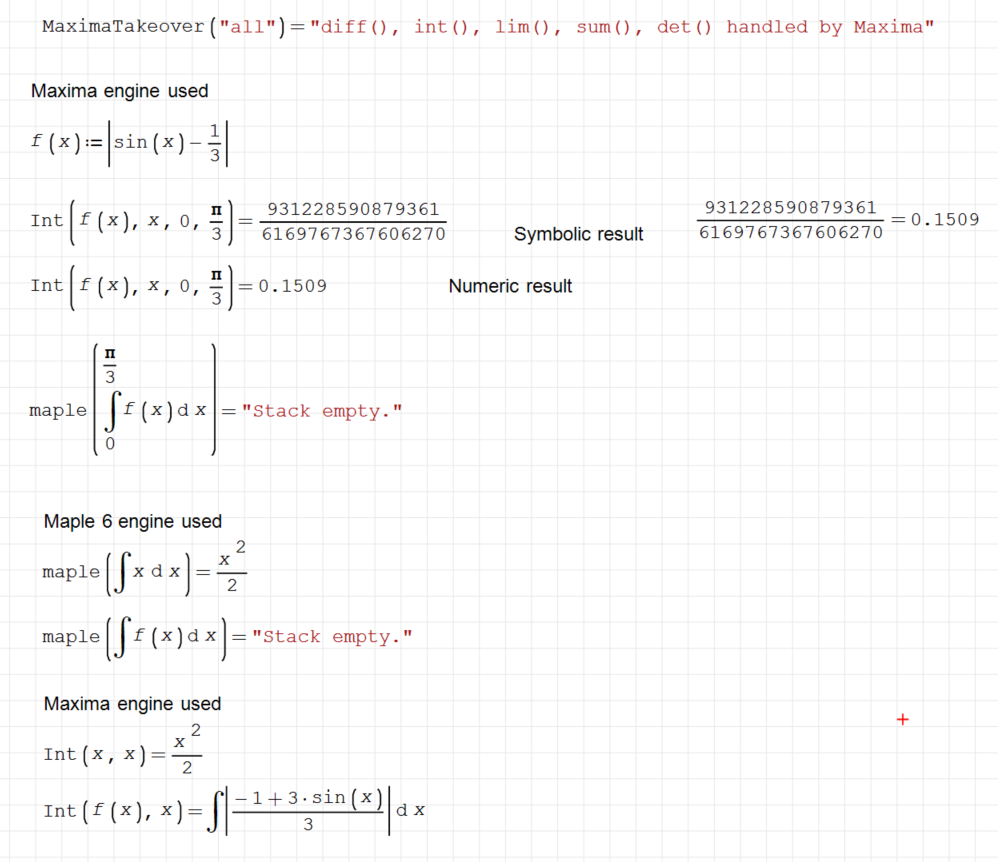

I see also the difference between Maxima engine and maple version 6 engine (in symbolic answer). With maxima engine the result is more a rational approximation of an irrational result. I would expected something similar as maple engine give when evaluating integral symbolically.

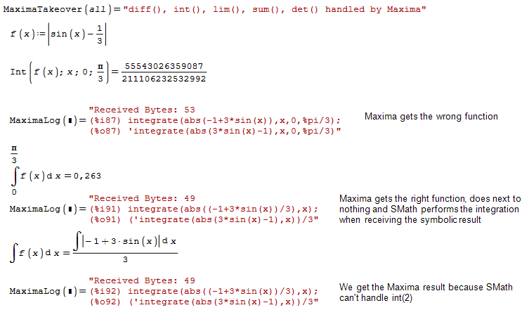

Maxima can't handle the integral. It returns a slightly modified symbolic representation. This is hidden by SMath postprocessing of the symbolic results (which doesn't seem to be suppressed for Optimization> None.
There seems to be a problem in preprocessing/translation when using the Int() function.
Worksheet20.sm (7,27 КиБ) скачан 1537 раз(а).
