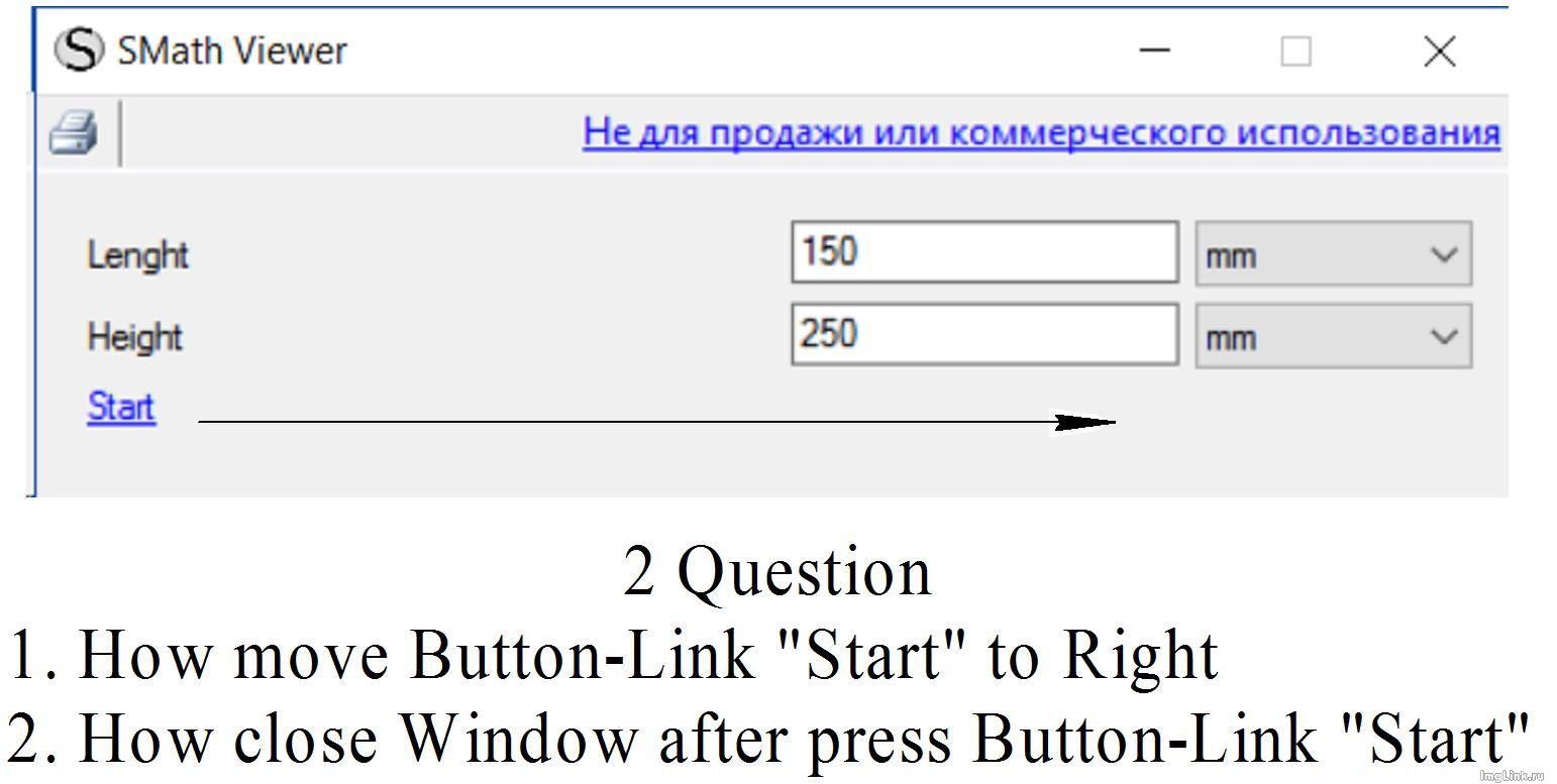

Hello Davide Carpi
I decided to use Smath Studio (Smath Viewer) as form to enter and calculate data.
The user then presses the Start button (as shown in the picture) and then start my program.
So I would like not to confuse the user and close the data entry form, ie Smath Viewer (executable file *.exe)

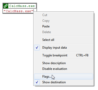

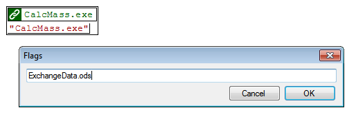

And another question
since You are a developer Hyperlink Region
It is possible to expand the possibilities of this Extensions:
Add command-line arguments when you start the program
For example:
"CalcMass.exe - ExchangeData.ods"

Sometimes is not possible to close the viewer because internal exceptions, so I've thought about a bug.
I'll check if there is a safe way to kill the application within the hyperlink.
You can always add a text to ask the users that after clicking the link they can safely close the program.

You already can; right click on the region, choose "Flags..." from the context menu, and then add the arguments you need.

Thank you very much
Really works with the flags
