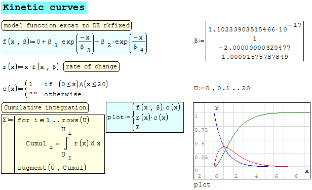

For this DE system, as proposed by Uni, an exact model function is given.
From which, the explicit analytical rate of change results, then the
cumulative integration. If we have done right ? Answer: YES.
