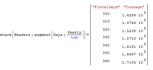

The question is simply clear ...its should be a matter of removing or adding x3 zeros
aMIR.sm (10,5 КиБ) скачан 821 раз(а).

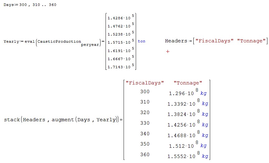

Simple as the question

Thanks ...but can you tell me what is the wrong in this kg <> ton ...it should just reduce the power to 10 from 8 to 3 without changing the values
#4 Опубликовано: 14.05.2018 06:04:53
1 440 сообщений из 2 927 понравились пользователям.
I missed it...

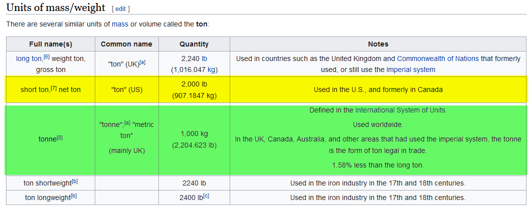

You have to use 't (metric ton) because 'ton here is the US "short ton"

I think its the problem ...I was expecting MetricTons
Problem solved
