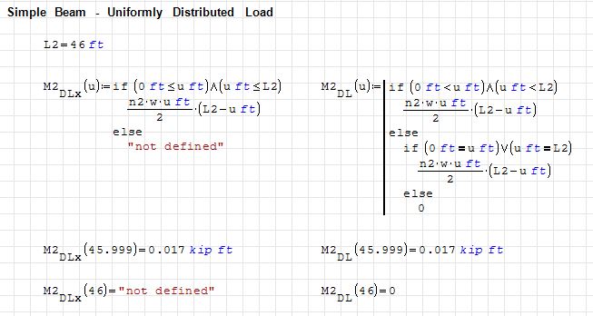

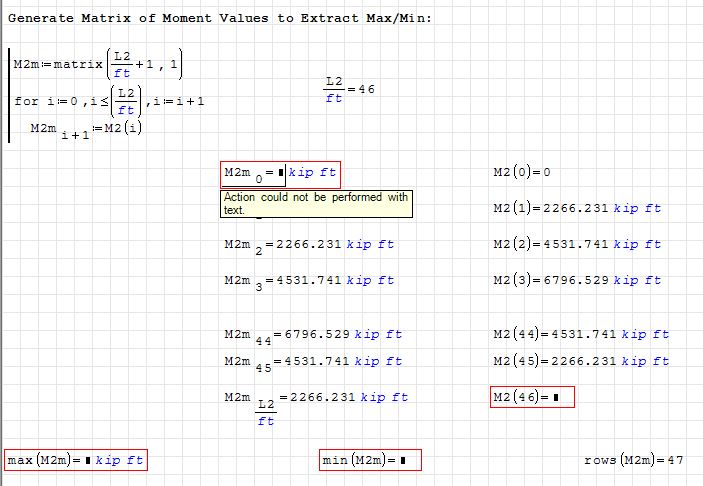

When generating a matrix from a previous (working) user defined function in SMath, it was giving the results that I was expecting, until I did "something" (I have no idea what) and I started getting the following error message:
"Action could not be performed with text."
(Strongback - Error.sm, attached)
Trying to troubleshoot it, I made a copy of the file (Strongback - Test.sm, attached) and all I think I did was change some of the input values to some smaller/clearer numbers. And it was working fine, without errors.
Can anyone point out what I might have done to generate there error?...Thanks!

el(M2m,0) simply doesn't exists, matrices and vectors in SMath are base-1 (1, 2, 3, ...); the error message is wrong (something in the priority of the exceptions, probably).
you can check yourself M2(46) using the "none" optimization, is "not defined"+"not defined", since those strings are output of your functions M2.DL(u) and M2.p(u). You have to define in a better way your function or handle differently the output.

I had been (incorrectly) under the assumption that the matrices were base-0. And I had not noticed that my user functions were not evaluating as I had expected at the limits. I was assuming that M2.DL(46) = 0 and not the "not defined" value that it was actually returning.
For my own future reference, do you have any idea why the "if...(46-ft = L2)" statement is returning FALSE and going to the final "else" statement? I switched around the Optimization setting (which I am not real familiar with) for those functions, but it didn't seem to have any effect.

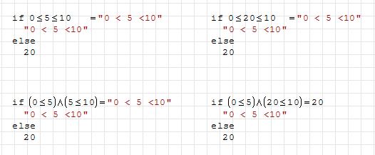

And just to note this down, when working with "IF" statements and BOOLEAN conditions in SMath, is seems better...
...to use ( a <= b ) AND ( b <= c ) structure
INSTEAD of ( a <= b <= c )

you can use the "lele" command after loading the plugin Function Extension
