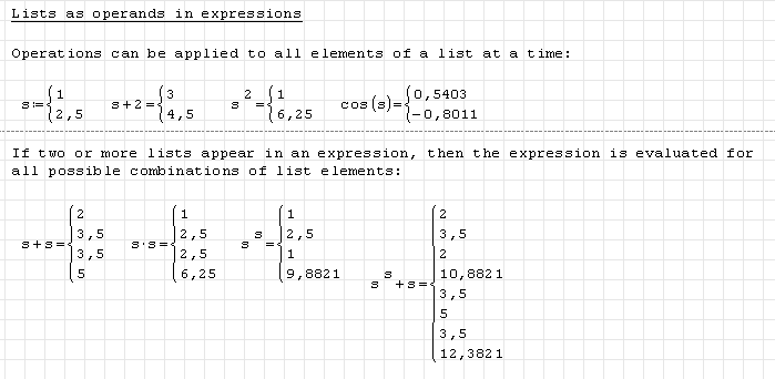

#7 Опубликовано: 21.09.2013 08:10:45
Note that SMath does not return the correct result.
Lists and list operations are not a good representation for vectors and vector operations. If lists obtained by pol2xy are to be added, they must be converted to vectors using sys2mat().
