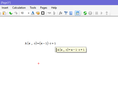

When the cursor is over an equation, it shows the long version of it. However, the tooltip equation (with the yellow background) misses often brackets, which makes the equation wrong. See attached:tooltipproblem.png

Thank you! Will fix it asap.

Fixed. Will not be an issue anymore in the next SMath Studio release.

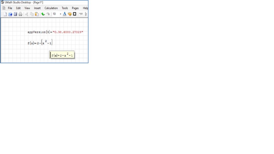

Tool tips problem.
Tooltip.pngTool tips problem

Fixed: http://en.smath.info/forum/yaf_postst7719_SMath-Studio-0-98-6081--25-August-2016.aspx

Thank you Andrey!
It works fine
