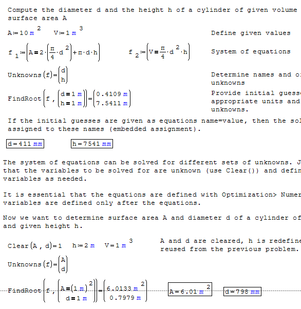

Radovan, thanks for the demo video of the handbook.

I cannot reproduce the solver problem in the screencast. The default precision is 4 decimal places, whatever that means: 4 significant digits (would be the preferred and only unit-independent variant) or an epsilon setting of 10^-4.

One minor observation. I still do not understand why I should use CTRL+click for using the links, while in the Reference Book just simple mouse click will do the thing. Keeping the finger on CTRL button while browsing the files and contents is not quite appealing.
About the FindRoot() in your example. I do not know why I get different result (Win7 64bit), but I messed up with different Nonlinear Solvers by Davide (some of them were totally unofficial). I think we should not worry about this at the moment. We will see when Davide announce the official version.

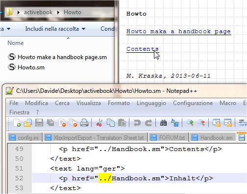

2nd (@Andrey) I think that an additional attribute could be added to enable/disable an "Handbook mode"; f.e. that option can enable the toolbar that you have provided for the reference book
3rd (@Martin) IMHO, as for now, a tree-based structure for the files is needed (at least a simple double level structure) to make the Handbook file easier to find (I've attached a couple of screenshots); in the other hand if Andrey found a better way to handle SMath's handbooks, an additional attribute "Handbook root" applied to the main file would be enough

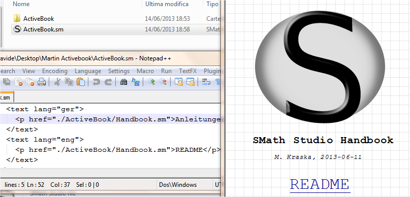

That is because all files are in "editible" mode for now. You can't edit links, if clicking them jumps to the target. Andrey has added that upon request by me. You can reset that in the file properties dialog. Before that change, you also had to change the visible text in the editor, it was extremly tedious and error-prone. If Andrey some day includes the handbook in the official distribution, then best would be to reset automatically all involved files to non-editible.
I guess that the handbook can easily be hooked into the reference book by adding an appropriate link into the contents page of the reference book. But I shall do structural changes (nested directories and the like) only after efficient link target editing is available. For now, the need to find the handbook root is mitigated by all pages having the back link included.
That is because all files are in "editible" mode for now. You can't edit links, if clicking them jumps to the target. Andrey has added that upon request by me. You can reset that in the file properties dialog. Before that change, you also had to change the visible text in the editor, it was extremly tedious and error-prone. If Andrey some day includes the handbook in the official distribution, then best would be to reset automatically all involved files to non-editable.
As soon as I posted this, I remembered that the files from the Reference Book are not editable. I asked that Andrey long time ago, he explained and I forgot - as usual. I also understand your point now. Thank you.
#9 Опубликовано: 14.06.2013 11:59:08
Strange, this is not happening on my Win7 32bit
You're right
BTW a 3rd way could be to add all the worksheets inside a folder and to add an additional "cover" worksheet outside this folder with a link to the HandBook.sm; this not require many efforts and help to have a clear front-end.
I've seen now your video, I do not understand from where the initial results come...

How about this one. Just unpack the contents of the zip file in post #1 to a subdir activebook in your smath book directory and exchange the attached contents.sm. Then you have handbook access via Help.
