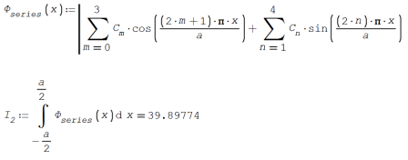

I have an equation that is dependent on the summation of terms and I need to integrate that equation. I can do it if i evaluate the summations myself but I am going to need many terms and was wondering if there is a way to do this without having to evaluate it myself?
I have attached a file of the equation I am trying to integrate.intsum.sm (12,8 КиБ) скачан 1165 раз(а).
#2 Опубликовано: 20.02.2019 19:45:22
Hi Camdem. Use line(...) for prevent the evaluation in Phi.series function. Then, integral could be evaluated.
intsum.sm (12,88 КиБ) скачан 1196 раз(а).

Thank you very much Alvaro

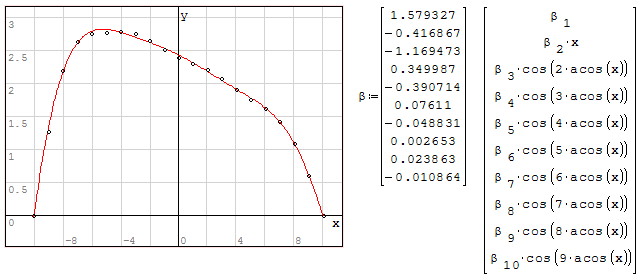

Thanks Cam, you express yourself very well.
I retain that on some experiment S(x) is not profitable,
then in lieu you propose the trig summation ... Ah !
Therefore: you construct accordingly to what S(x) fails.
At this point, and assuming that the "Camel shape" does not
do too much "monkey branching", linfitCheby is a much better
candidate as you just need to set the ChebyShev oder.
The final export is a gracious function ready for scientific calculator.
"linfitCheby" resulted for the extension of the Mathcad built-in 'linfit'.
More can be done as we can mask some components.
Two more candidates are valid: OVNI model, Fourier Budapest 39
More data sets are needed to examine their applicability.
Cheers Cam ... Jean
Genfit linfitCheby.sm (77,25 КиБ) скачан 1141 раз(а).
