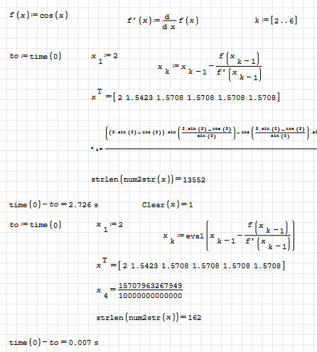

Hi. This example can illustrate what Davide says.
using_eval.sm (19,85 КиБ) скачан 1489 раз(а).

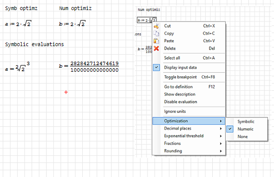

Hi. There is something like that, the Optimization/Numeric option from the contextual menu. You can also select all expressions with Ctrl-A and choose that option for the entire worksheet.
num-optimiz.sm (71,39 КиБ) скачан 1482 раз(а).
