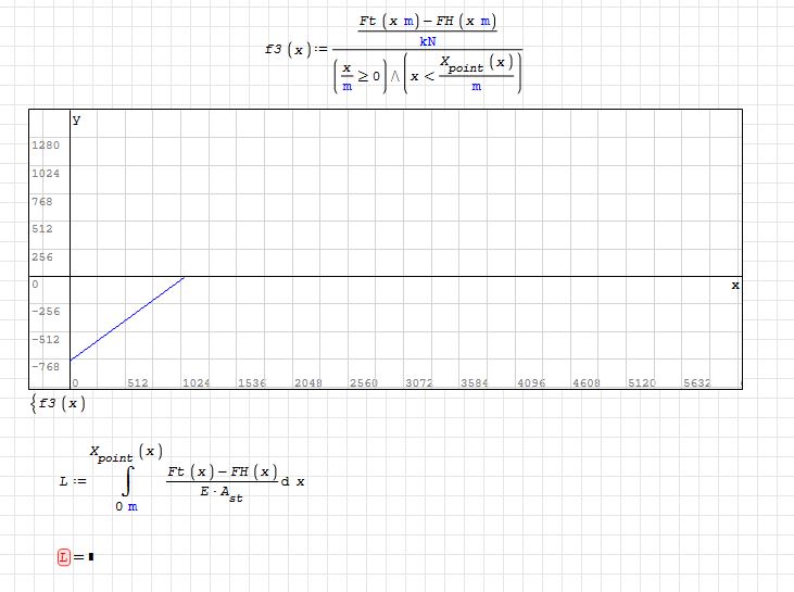

Hi All,
Anyone can help to point me how to integrate equation between a range to find the area unde the curve / function. Been trying loads of way to change the integral equation, but no luck.
Manage to get this done in a simple equation, however can't get when there is a vector

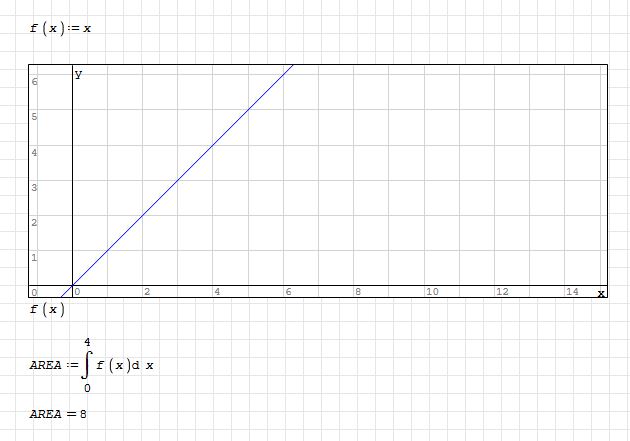

#2 Опубликовано: 11.01.2021 17:35:11
Units freak projects top2bottom ▼
Integral (1) DoctoredRed.sm (37,69 КиБ) скачан 1016 раз(а).

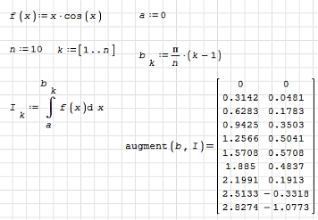

Hi. For do things between a range you have several options in SMath, like vectorize() or for loops. This is using range variables:
Isn't clear which range do you want in X.point(x)
